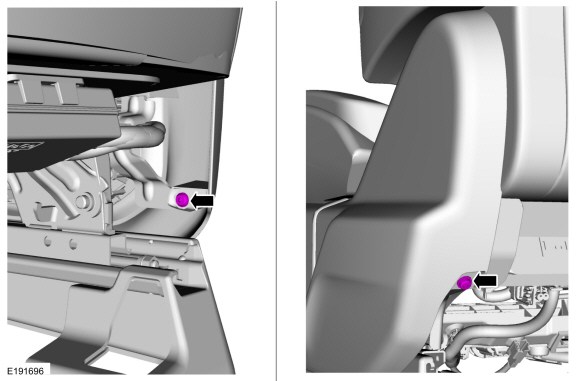

  1. Remove the side shield screws.
Manual seat
  1.

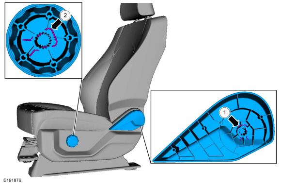

    1. Remove the clip and the recline handle.
    1. If equipped.
      Remove the clip and the lumbar handle.

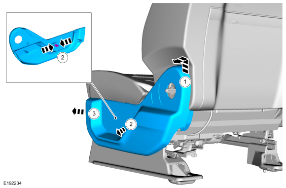

  1. Remove the side shield.
    1. Firmly grasp the side shield, lift up and out, separating the side shield from the recliner bracket.
    1. From underneath, squeeze the retainers together and pull out on the side shield.
    1. Slide the side shield forward.

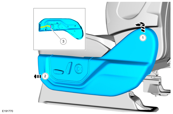

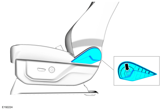

    1. Lift up on the rear of the side shield and pull outward.

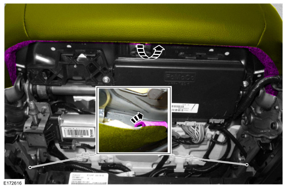

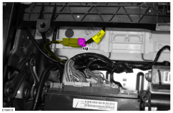

    1. Disconnect the electrical connector.
All seats
  1. Release the elastic strap from the seatbelt buckle.
  1. Position the backrest wire harness(es) aside.

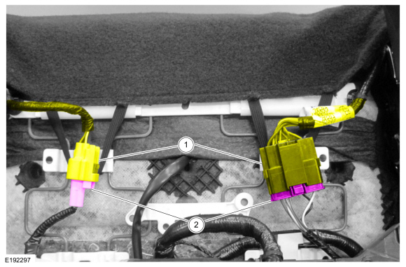

    1. Release the electrical connector retainer(s) from the seat track.
    1. Release the locking tab(s) and disconnect the backrest wire harness electrical connector(s).
  1.

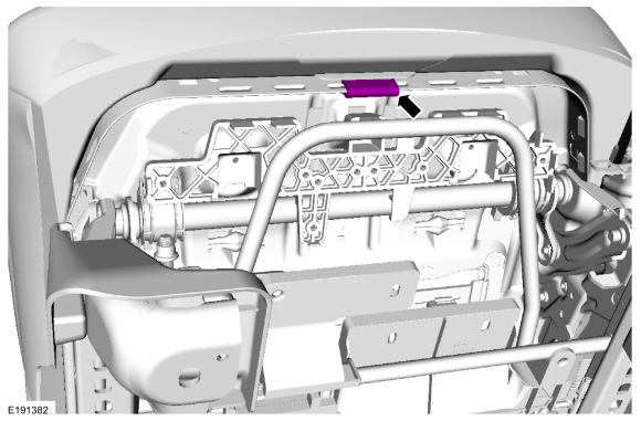

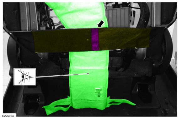

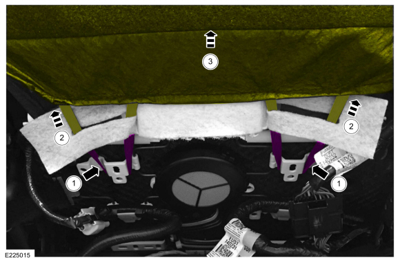

    1. Detach the backrest cover straps.
    1. If equipped.
      Route the backrest cover straps through the backrest blower motor snorkel.

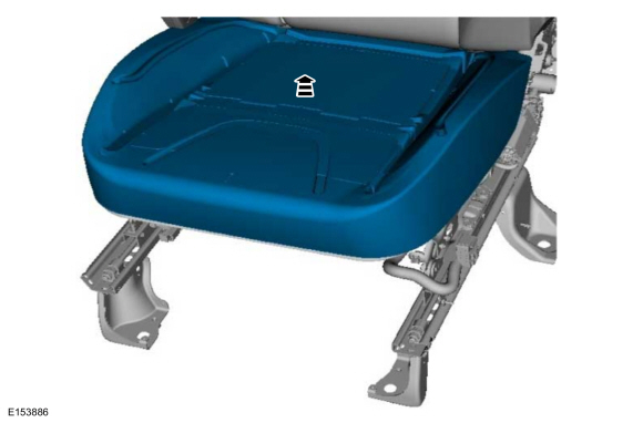

    1. Position the backrest cover upward.

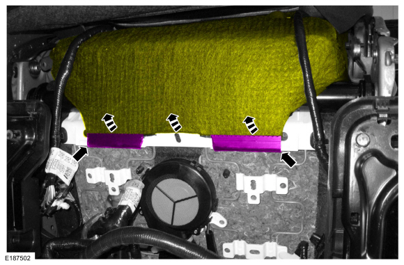

  1. Detach the cushion cover J-clips and position the cushion cover upward.

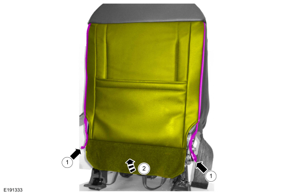

  1. Detach the backrest cover lower J-clips.
  1.
    1. NOTE: To install, gradually alternate the left and right seat backrest cover zippers to prevent damage to the seat backrest cover.
      Unzip the backrest cover zipper on each side.
    1. Position the backrest cover up.
  1. NOTE: For installation of a backrest blower motor with snorkel, note the routing of the snorkel.
    Detach the hook-and-loop retainer and position the backrest cover strap aside.

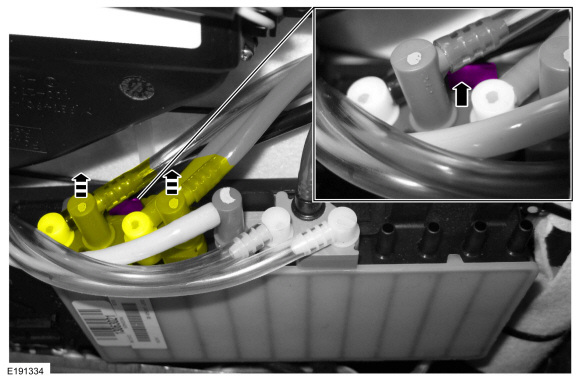

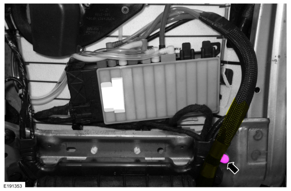

  1. Detach the multi-contour seat cushion hose retainer.
  1. Release the locking tab and disconnect the hose coupling assembly (orange) from the SCMG.
  1. Feed the multi-contour seat hose assembly out through the backrest cover opening.

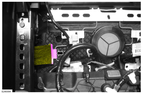

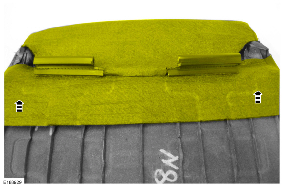

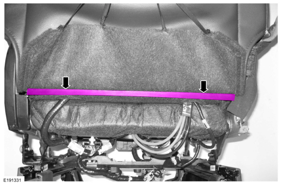

  1. Detach the J-clip and position aside.

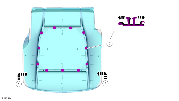

  1. Release the J-clips and position the front of the seat cushion cover and foam assembly slightly upwards.
  1. If equipped.
    Detach the cushion heater mat J-clip.
  1. Remove the seat cushion cover and foam as an assembly.
  1. NOTE: This step is only necessary when installing a new component.
    Invert the rear portion of the seat cushion cover.
  1. NOTICE: Use care when separating the seat cushion from the hook-and-arrow or the hook may be torn from the seat cushion foam pad.
    Remove the seat cushion cover.
    1. Invert the seat cushion cover.
    1. Release the hook-and-arrows.
