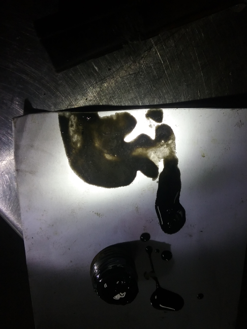

I have a '11 Crown Vic with 300k miles on it and my rear diff fluid looks like this...
Been watching some utube vids on how to change this fluid out but after a visit to the local Advance store I've got some questions. Up til now, forums on the net have led me to believe that all former police cars (which is what mine is) need 75w-140 fluid with friction modifier, but after giving them my VIN at Advance the computer comes back with a fluid suggestion of 80w-90.

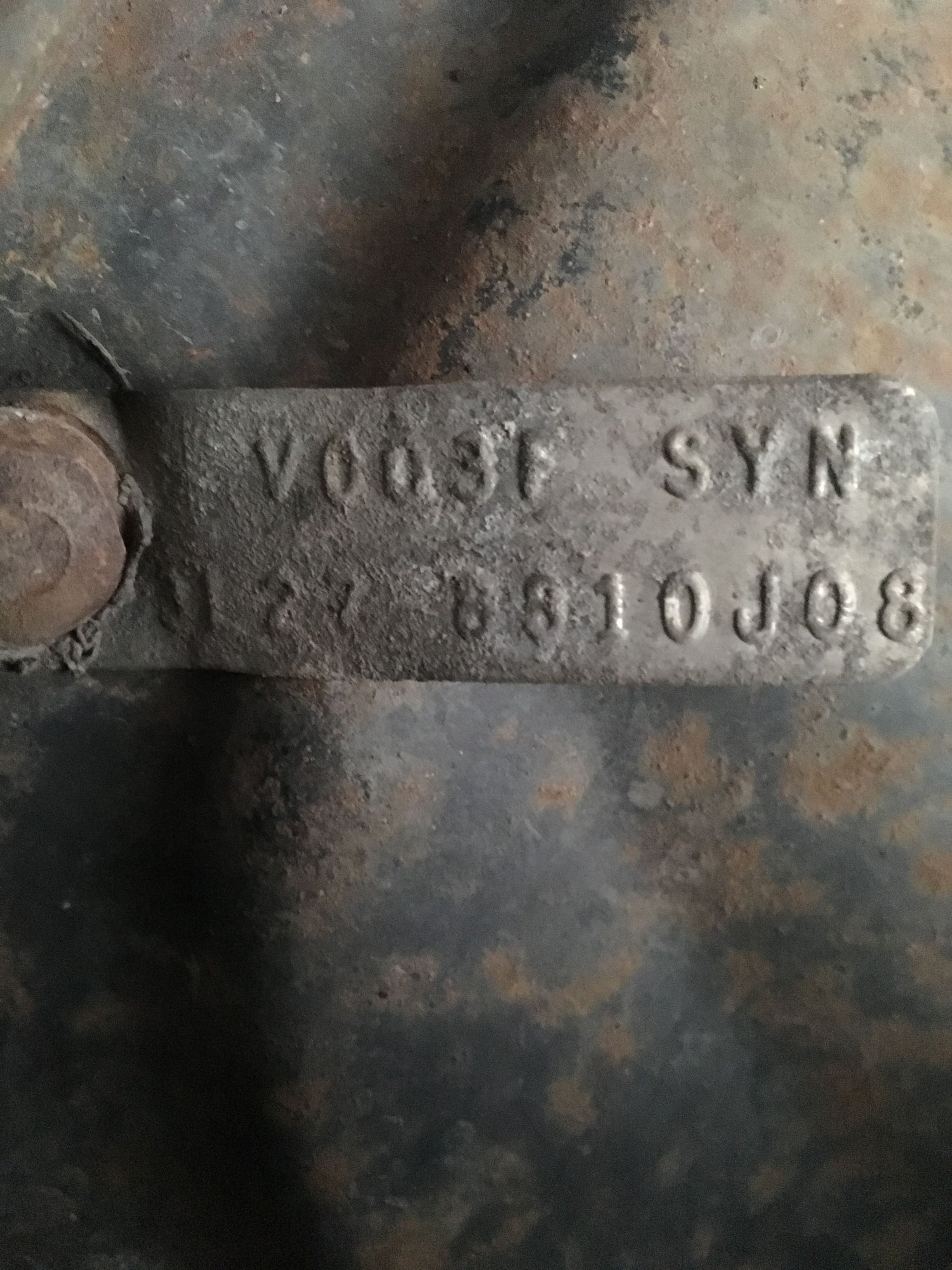

Here's the diff tag...
I believe that shows a 3 (L or 1)? 27 which indicates a 3.27 gear ratio, and then an 88 after, which indicates the 8.8 axle. Not sure what that SYN means, unless it means synchronous?

Next is how to go about changing the oil out. I'm being lazy here and after watching a vid on how you can extract 80% of the diff fluid out the fill hole by using a flexible hose I'm thinking about just doing it that way. But if you guys think it's necessary to get all that old fluid out I'll take plate off and do it the regular way.And lastly, if I take the plate off, should I spray all the gears down with brake cleaner to get all the old fluid out, or just let it drain for a while and call it good?

"When the rear is jacked up and one rear wheel is spun, the other moves in the opposite direction."
That tells you that it's an open differential. Even with work clutch packs, both tires would turn in the same direction.
Being at 300K, I would do a cover off "CLEAN & INSPECT". Then just add a fresh 5.1 pints filling of 75W-140 Synthetic as required.
No friction modifier required on open differentials.
