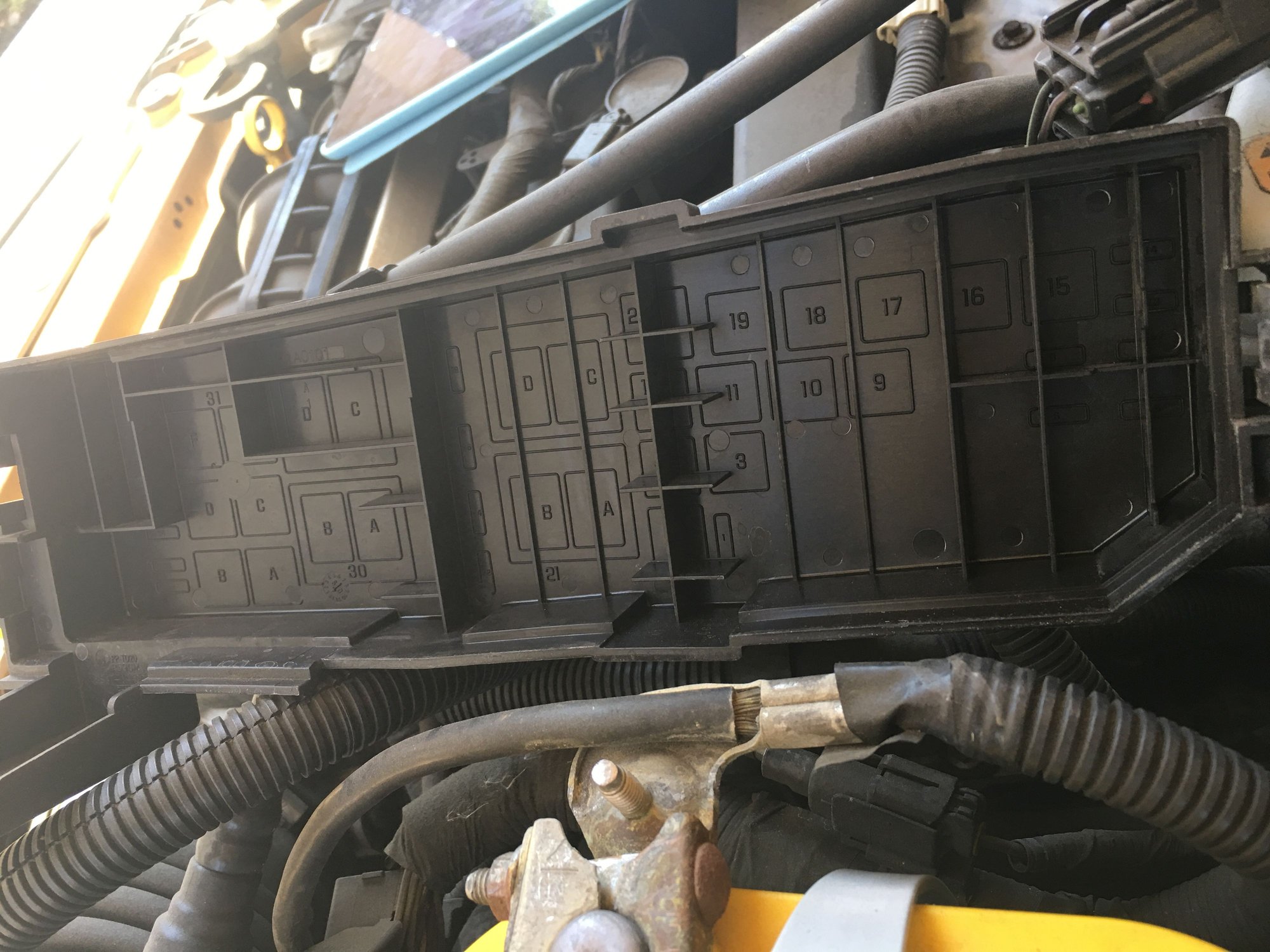

Ive been searching online for the right number fuse but I keep finding completely different responses. Anyone out there with the same car that can tell me which fuse it is?
Would greatly appreciate it!!

The printed material I was able to examine didn't show any particular fuse for any lighters.
If it is a fuse, there is another easy way to confirm that. If you have access to a test lite , just connect the ground clip to a good ground and check both sides of each fuse at the top. If one side lites, the other side should lite also if the fuse is good. Quick and easy.
You may not get any light from some fuses if the ignition is not on/active.
