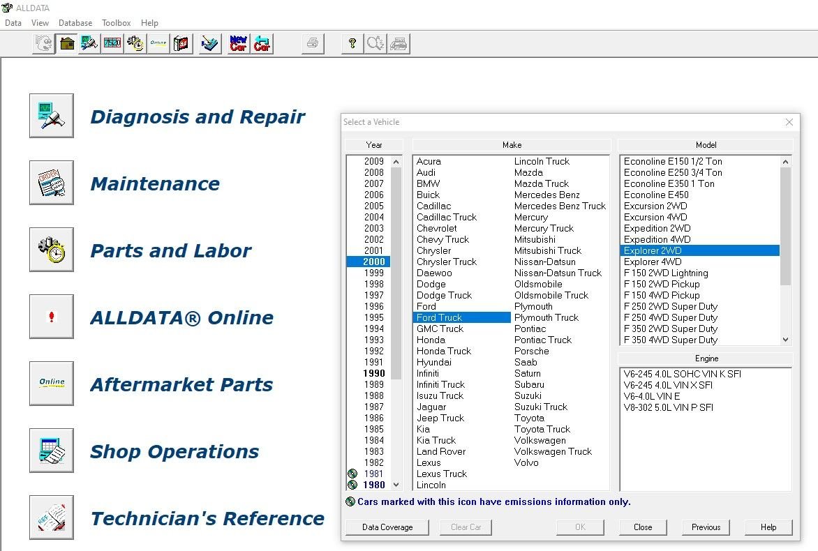

1) Do NOT start threads in General Tech anymore, all the threads you started should be a dedicated Explorer forum instead.
2) Don't be too lazy on your subject title.
3) Check my signature below, when it comes to any vehicle in ford you don't put XLT, you put the other info.
As shown above OK button is not clickable because engine is not selected. If you have 4.0L what is the 8th character of your VIN? 3 possible choice still.
