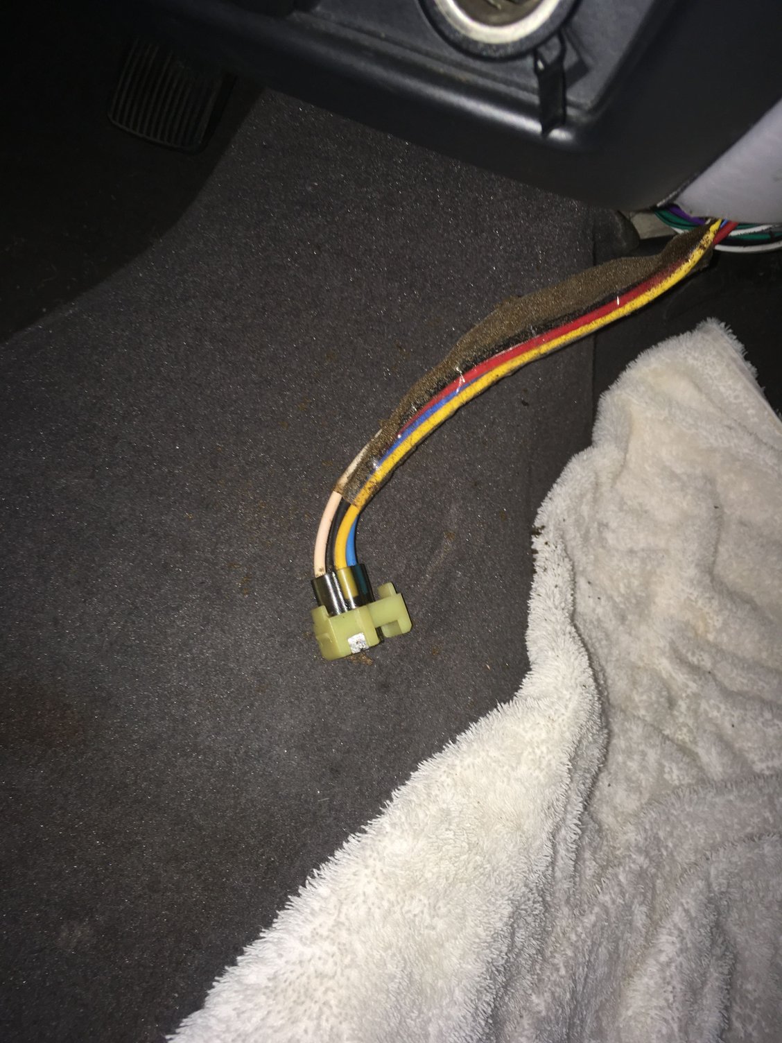

I checked all the vac lines on the firewall from the vac source on the driver's side to where it goes into the cabin on the pass side and everything seemed ok. So I get inside and take the glove compartment out and go poking around to see if I can find a loose vac line. Well lo and behold, I did, and lucky enough nothing's broken. I found a loose junction of vac lines that resembles a wiring harness connection. Best guess is it got knocked loose when my aftermarket radio got installed last year. Couldn't find my radio removal tools (on order for next week) so I wasn't able to get as good a view as I wanted, but after a lot of squeezing under the dash to look I never found these lines connection point. Can anyone tell me exactly where these lines plug into?...

If you can, hold iff until you get your radio removal tools..
It appears the plug could go on to the function selector of the heating switch section right under the radio. If that is correct ,you are right , an easy fix !
