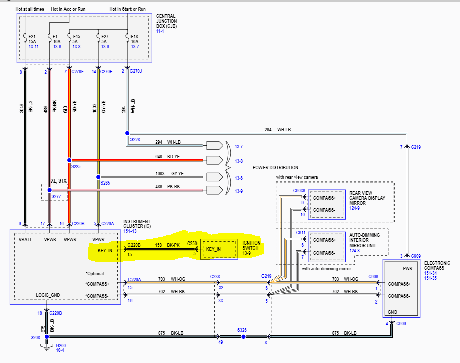

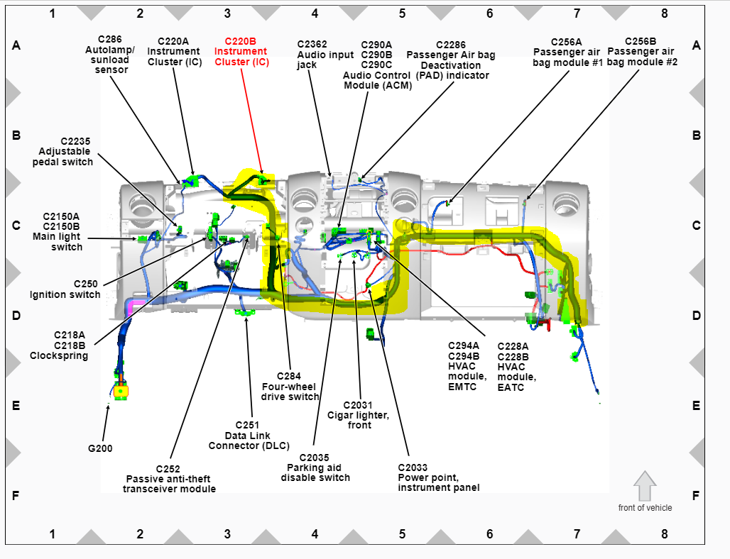

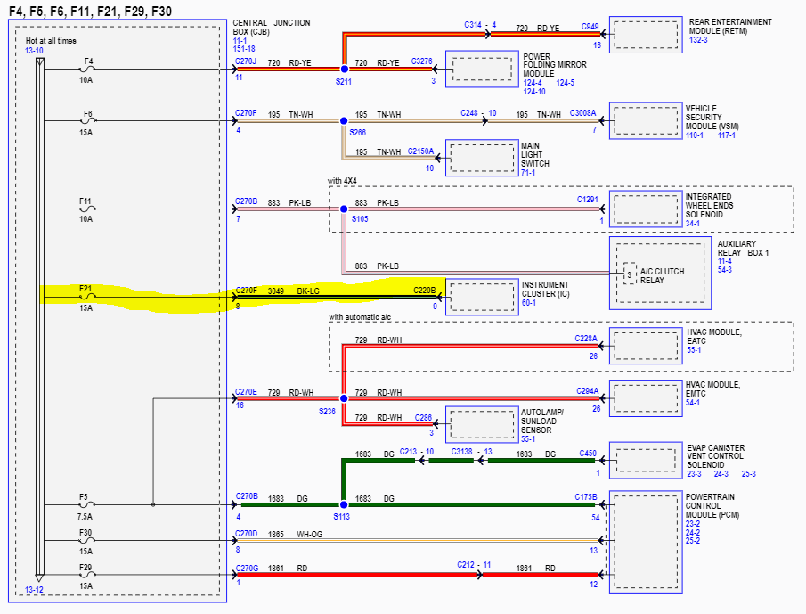

Here are some diagrams with parts highlighted that are relevant.w
As you noted there are two connectors for the instrument cluster. Based on the attached pictures can you specify which you are calling the right one and the left one, C220A & C220B are the connector names. Some people talk about left and right sitting in the drivers seat, others talk about it standing in front the truck looking at it. Its a little thing but it can be very confusing when both people are talking about different sides.
Also might I suggest checking the other fuses shown to power up the instrument cluster, while they are unlikely to be blown since they power up other components as well it would be good to know they have not blown.
Also was the evac case removed during the installation of your brand new AC system?
