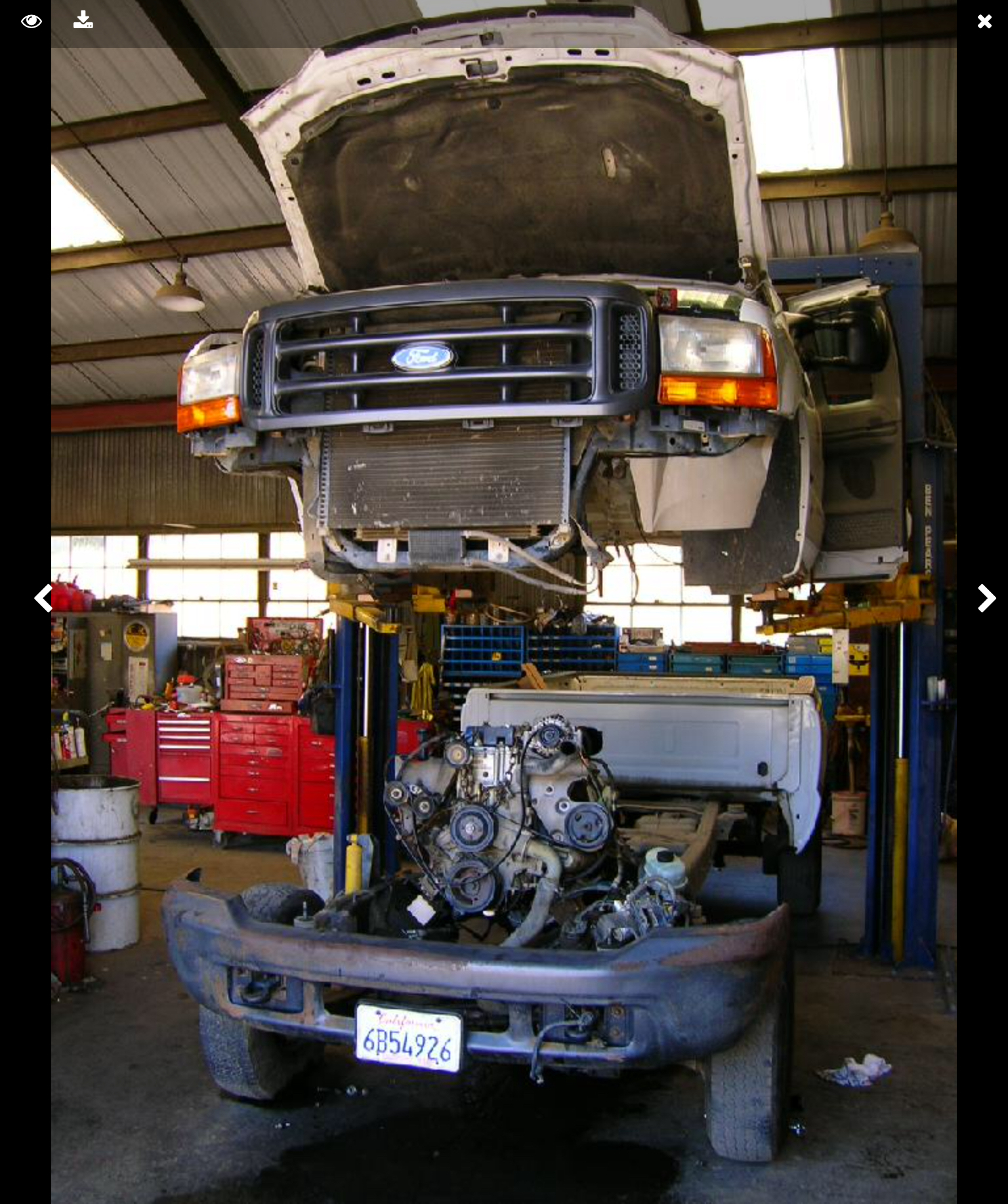

Swapping a cab is labor intensively, but not overly difficult. Having a car lift works well to cradle the cab at 4 points and lift/lower it under complete control unlike trying to use lifting equipment and slings etc. with less risk of damage,, but can be done either way. Of course the replacement would need to be placed on the lift (if available) and lifting a cab high enough to clear the engine for the chassis to roll through, requires some decent size/ capacity equipment..
Cab lifting if done all the time to access the 6.0, 6.4 and I’ve even done them on the 7.3.
Getting a replacement cab close to to the same year, equipment, may help with some of the labor time not requiring most everything to be swapped to your equipment level...
Heres an image of a 2000 SC, 7.3 I lifted to correct a whole bunch of problems created by the last guy
