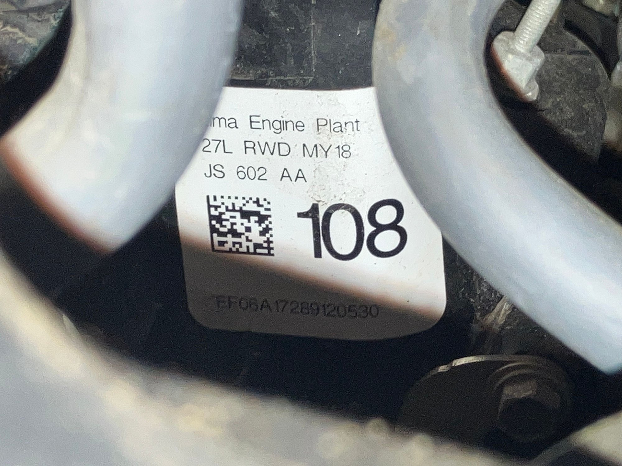

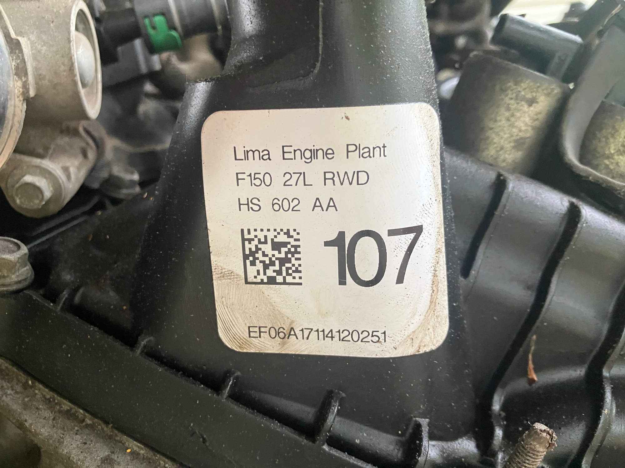

Old Jul 4, 2025 | 10:28 AM
Chase Childers's Avatar
Joined: Mar 2016
This is the 2017 2.7 that was blown and pulled.
This is the 2018 2.7 that was swapped bolted and hooked up just need wiring sorted
Old Jul 4, 2025 | 05:27 PM
I believe the info requested is what is on the door sticker of both vehicles and that may or may not be available.

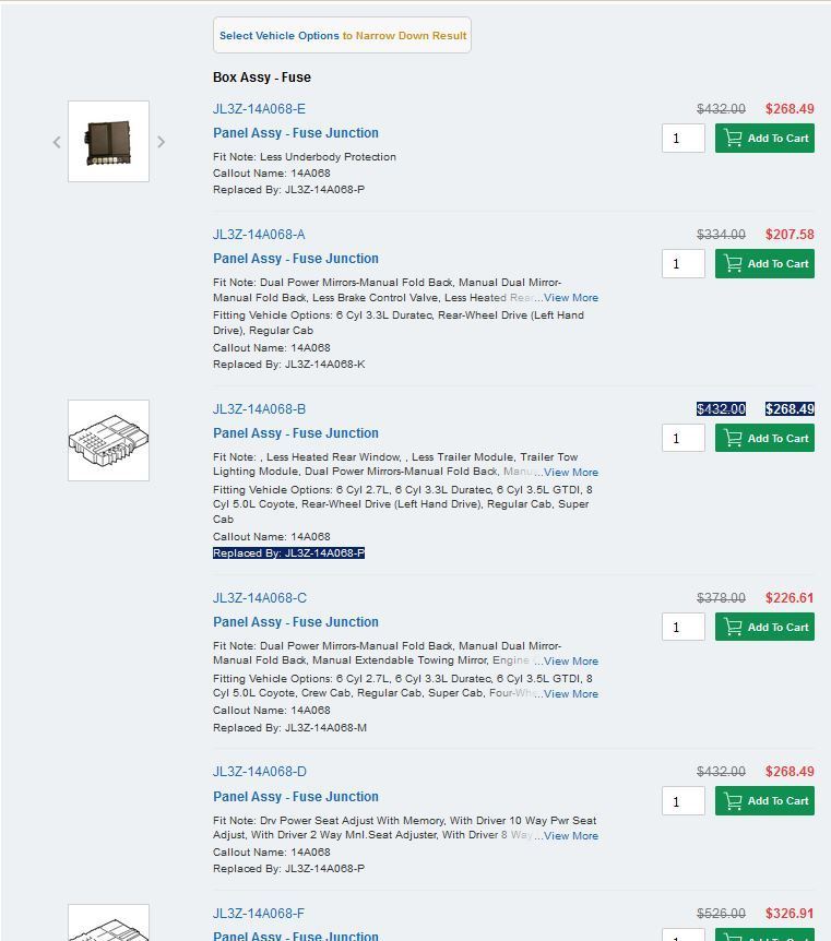

Old Jul 4, 2025 | 11:39 PM
On just the fuse box there are 9 different ones depending on the equipment and options.
Examples shown above from fordpartsgiant.com. There if you click on vehicle fitment you can see 2018-2019.
When you have a 2017, you will need to retrofit a 18-19 fuse box onto your truck. It's easier to get a 18-19 so you can plug the connectors in, whatever not matching, like I mentioned in my very first post, you can use inline fuse, so say F20 with a mini 5A, you pull that fuse from the fuse box, you run your own wire with inline 5A fuse and bypass the fuse box on that particular circuit.
Mechanical parts can be direct bolt on from 18-19 to 17, when fordpartsgiant already specified 18-19, you will probably need to move 10+ or 20+ circuits into inline fuse approach to complete the retrofit.
More than likely your PCM and tons of different modules are not compatible with your 2017 (can't even program it to make it work, especially when yours is a 2017, not 1997, so electrical compatibility is more important than mechanical), that means you might need to get all those off 18-19, and in the end there is only a slim chance your truck and start and run. It might be better off if you remove everything you put on, and look for parts off a 2017 or perhaps 2016.
