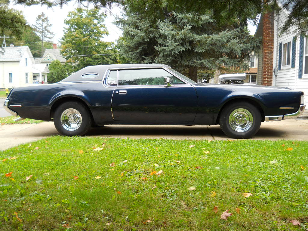

I have found so many kits for engine tranny combinations I couldn't believe it.
I want to get the tranny done first then move onto the suspension from there.
Here is the beginning of my start.

Oh, the influence of Lee Iacocca was truly something. First the Mustang, then the Mark. I always loved them. I would recommend that the conversion to an AOD might be problematic; I can make an AODE hold that torque, but the AOD with the cast iron direct clutch drum would be a problem. Also, I don't remember if Ford ever made a case for the AOD, AODE, 4R70 or 4R75E that ever fit behind a 460. There very possibly might be a conversion kit for this. Good luck, and please let us know about how it goes. And you're right, most parts from Ford will work on Lincolns (especially engine and trans parts), but some/most of the suspension parts are pretty Lincoln specific. Good luck, and please keep us posted!
