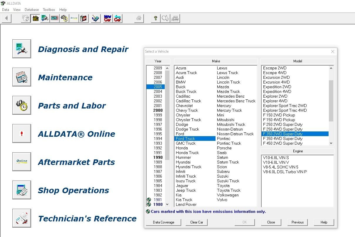

As shown above OK button is not clickable because ENGINE is not selected. Check my signature below to see why.
If you have a 6.8L what's the 8th character of your VIN?
Its a 2005 F350, 4 x4, 5.4 gas

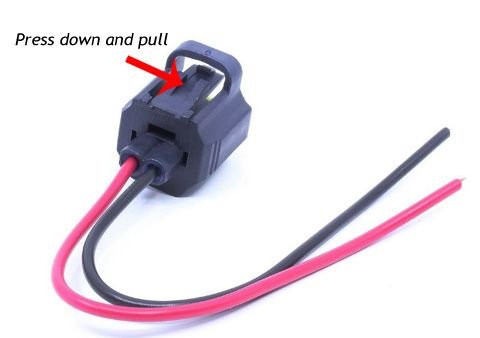

at Vapor Canister Vent Valve / Solenoid Connector looks like a simple press down the tab and pull.

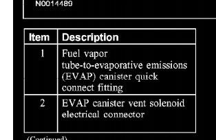

trick is to releasing the fuel vapor tube from the Evap canister

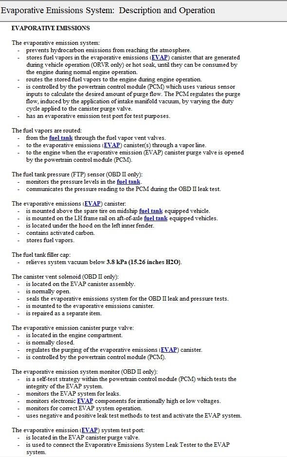

From page 3 of the PDF I attached previously:
Everytime you see "quick connect fitting" on Ford's vehicles they are pretty much one-time-use consider the age of your truck, so think twice before you attempt to remove. When it was brand new you simply squeeze both sides then push in a little then pull straight out, don't just squeeze and pull.

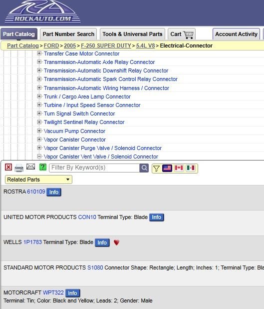

RockAuto is a good source to buy auto parts, not only that, before you attempt to remove a electrical connector, go there and locate it so you can see how the connector looks like on the bench so that you know how to remove it properly, just an extra step to minimize the chance you damage the connector.
I merely went to this page (based on your vehicle info:
The top pic I attached previously it was motorcraft WPT322. To see more you can also click on other 4 above.
United Motor Products CON10 for example:
If it's tight you can use both hands. Right hand to press the tab left hand holding a channel lock pliers to wiggle a little then grip and pull.
