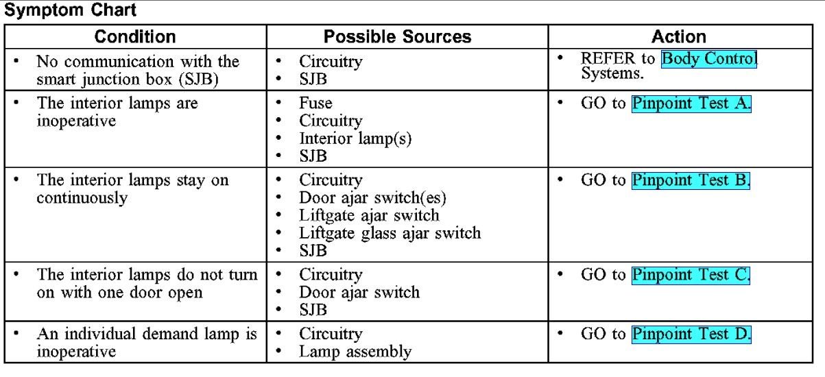

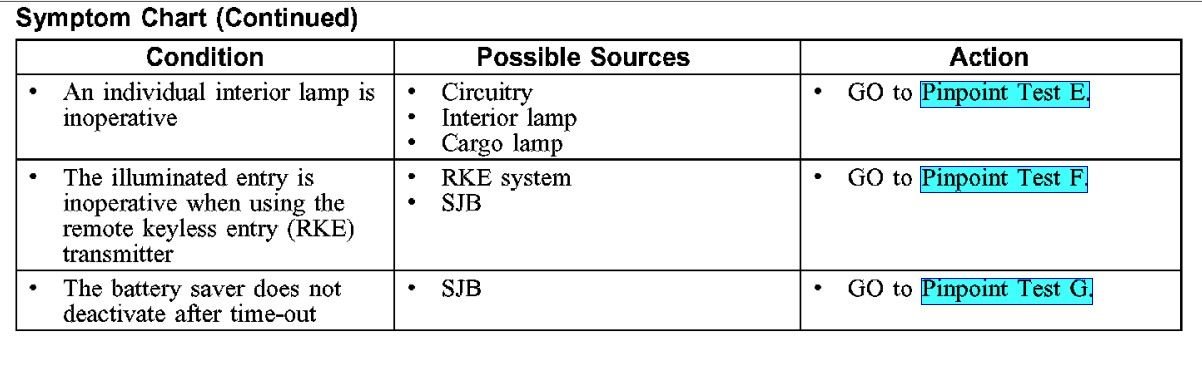

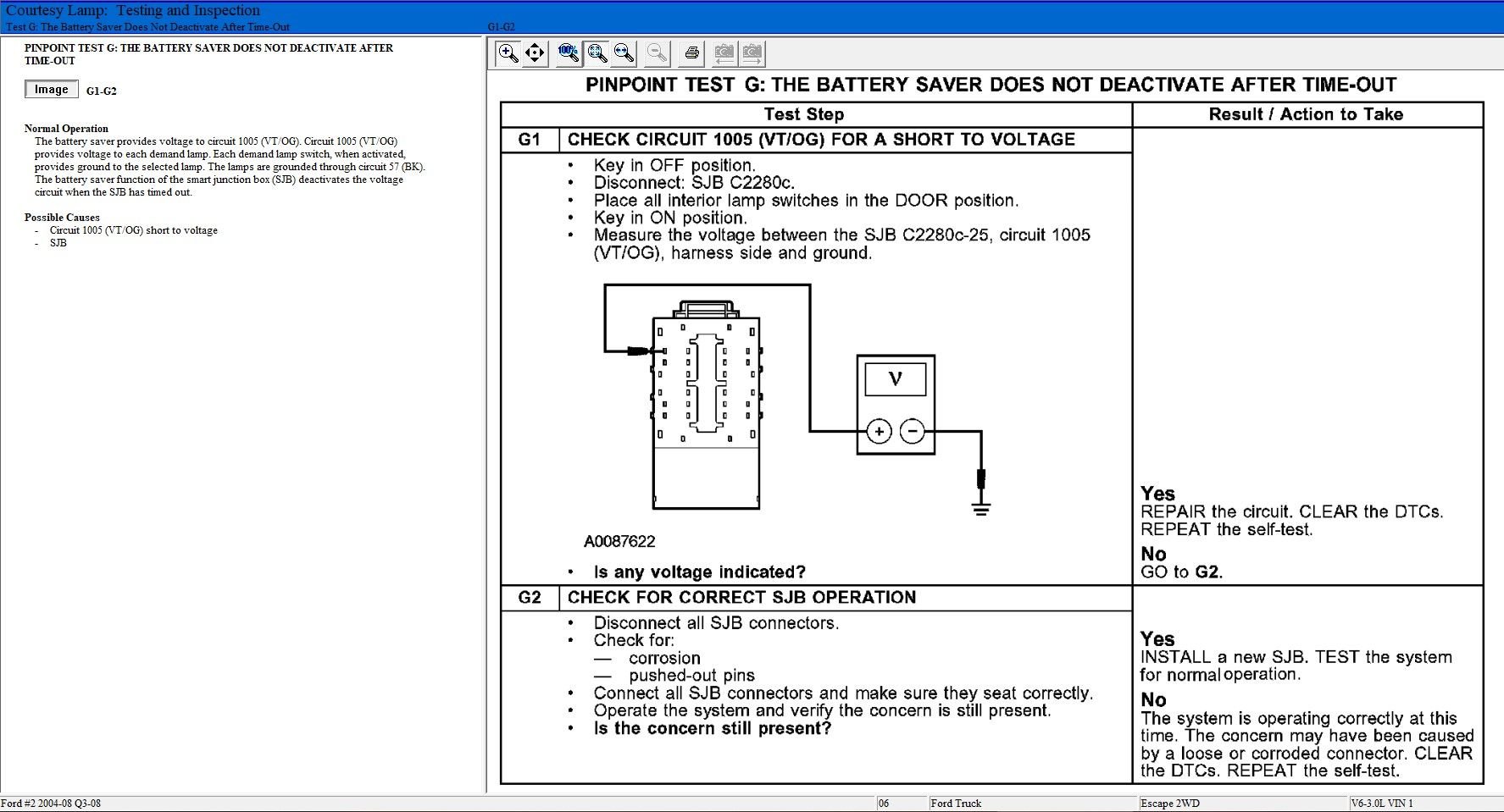

This might require a capable scan tool and in the special functions menu the delay time might be able to be reduced.in the lighting module.
Old Feb 23, 2026 | 02:37 PM

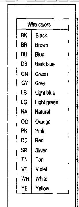

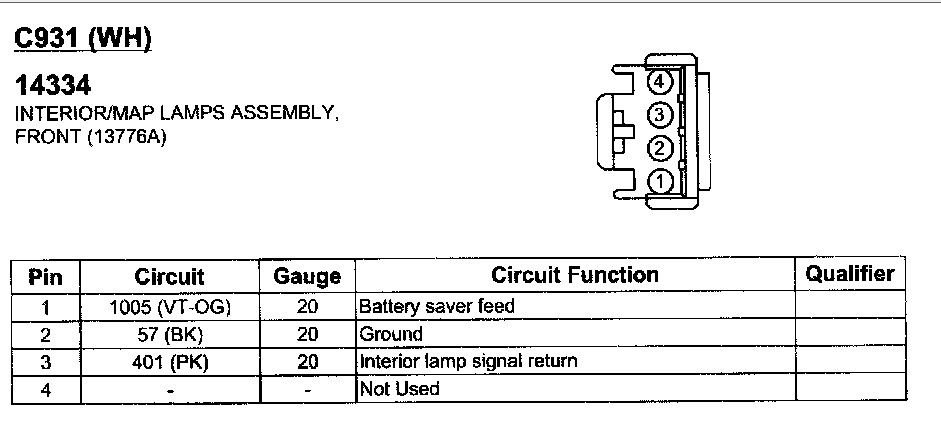

Pinpoint-G shown above. Pinpoint-B.pdf attached below.
