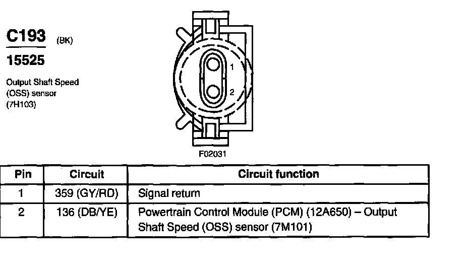

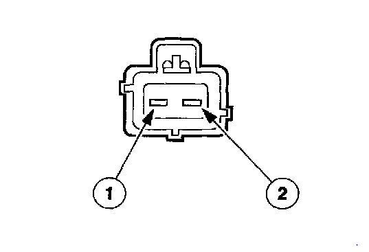

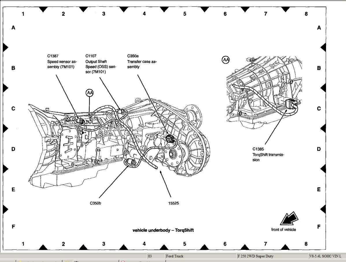

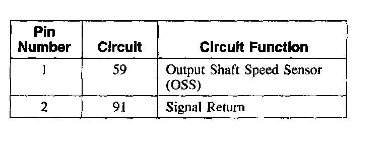

The last 2 codes relate to the output speed sensor on the trans. Suggest you check all the wiring going to and from the trans.
Check the plugs for a pin that might have been pushed out and driving finished the job..

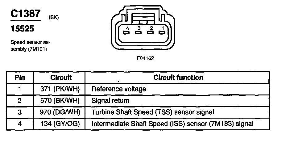

TSS Below:
OSS Below:
Two additional pdf attached below.
