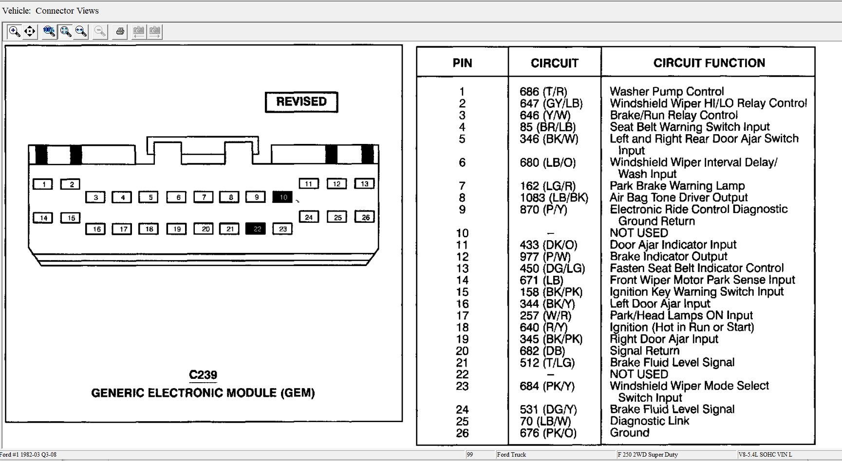

Below is diagram for C239, the GEM's connector view, you still need to know where GEMs are connected to, the relevant ones can all be found in Wiper_Washer_Electrical.pdf.
Before you buy another GEM, you have to test for bad wirings. Whatever is not working test those first, and just ignore the ticking sound for now since that might not even be originated from the GEM itself.
