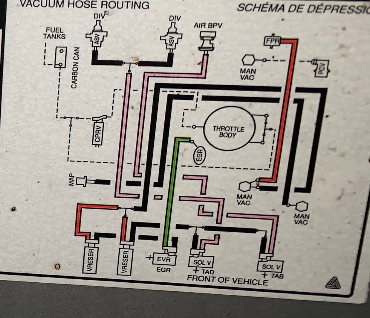

Well new update the 92 f250 with 351W and ZF5 , I did check to see if Any lines were so far no vacuum leaks . I did some vacuum lines going to the vacuum tank and Vapor canister line going to throttle body and tried the new ecm and rebuild ECM still stalls after reving up the engine so I put The ECM from the 302 back in for now and that one works good does not stall the engine out it has surged and stalled before on the orignal ECM

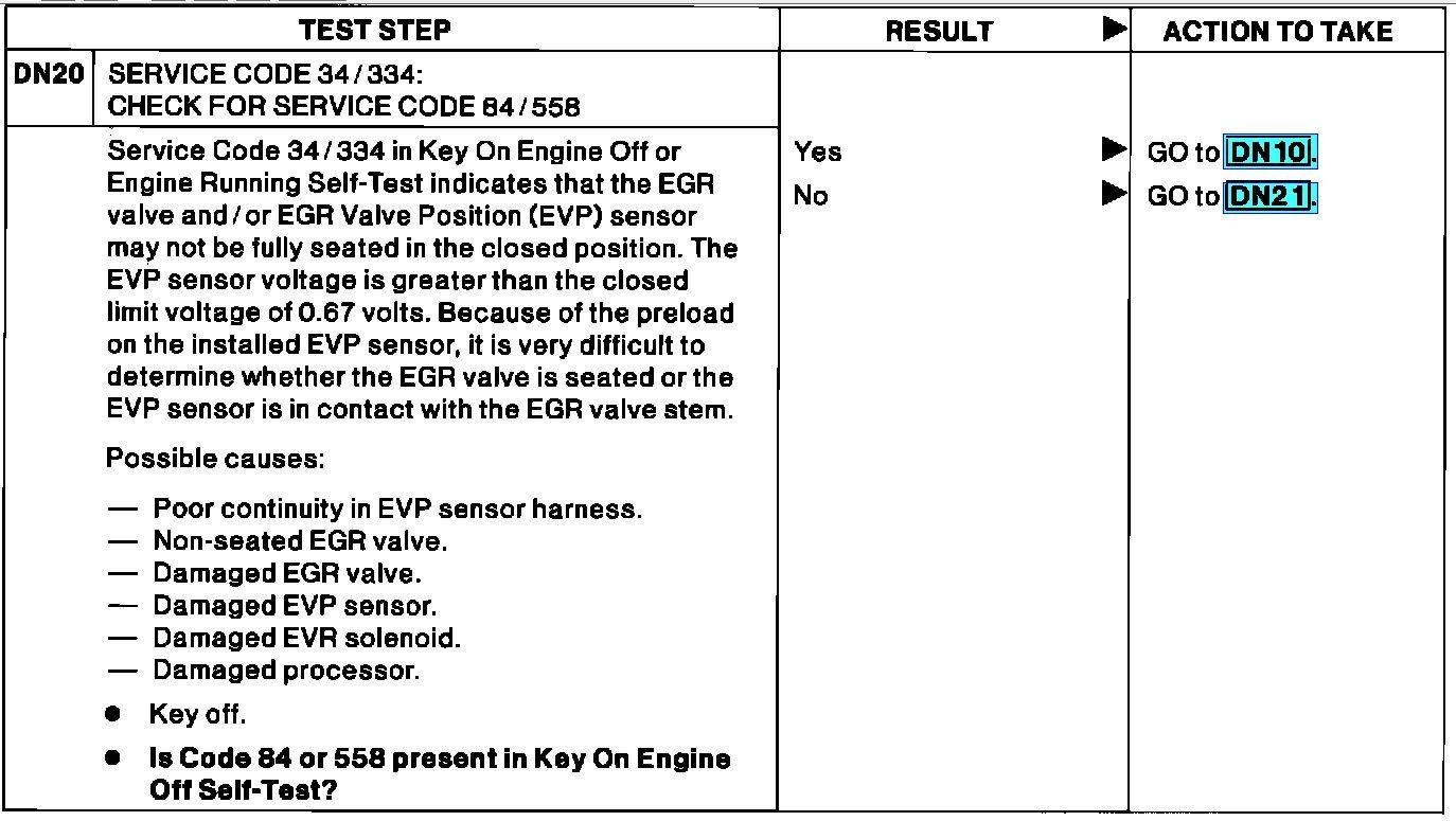

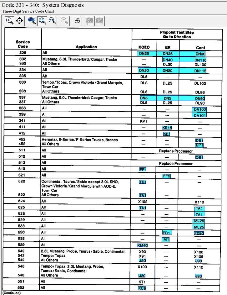

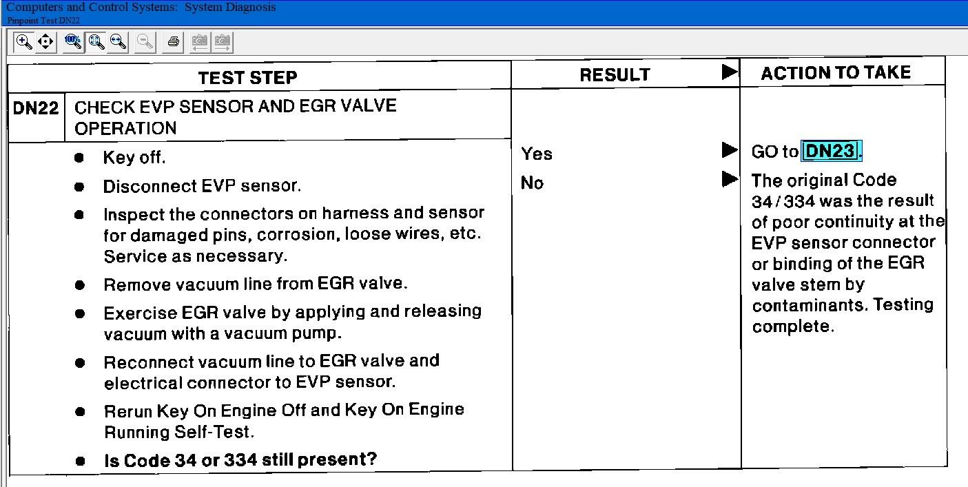

I plug it in this is what I got
This code was before I replaced the egr valve on it and code 111
I do have the engine vin number as well if you need it

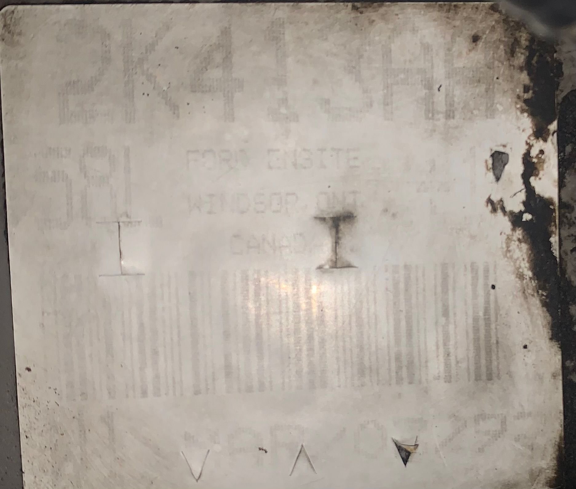

and the odd thing is 2 5.8 l ecms for the 351w and still stalling after reving the engine real hard but works fine on the ecm for the 302
Old Mar 14, 2025 | 08:28 PM

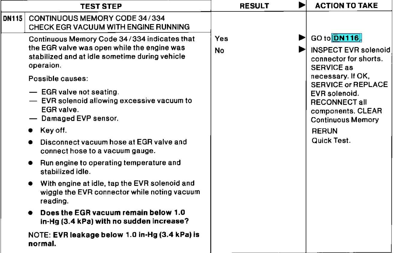

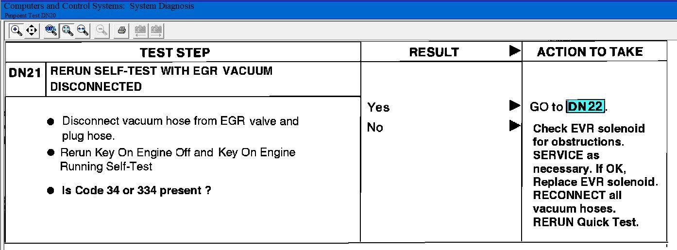

Perfect that is information of what I need and I have replaced valve position sensor last year when I did the egr valve but if engine light on intermittently or position sensor is not sending signal when throttle is open while the engine is warn then I would absolutely be sure that the egr sensor or stuck egr valve is the problem another thing to add My brother Cole said that my ignition control module has probably face planted it’s self he said where he had his 89 Ford f250 he had this problem happen ICM left the chat on him causing the engine to stall I have ordered another one it is motorcraft brand this time , anyway that is awesome of you sending me troubleshooting information that I need for chasing down problems that I need to fix.
