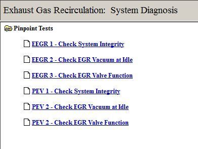

Why didn't you tell us you have obd1 scanner since part 1 of your thread from the beginning.
Don't forget to download the DN-ALL.pdf previously if you need to go further than DN22.
Here's more:
Pinpoint test pdf below.
