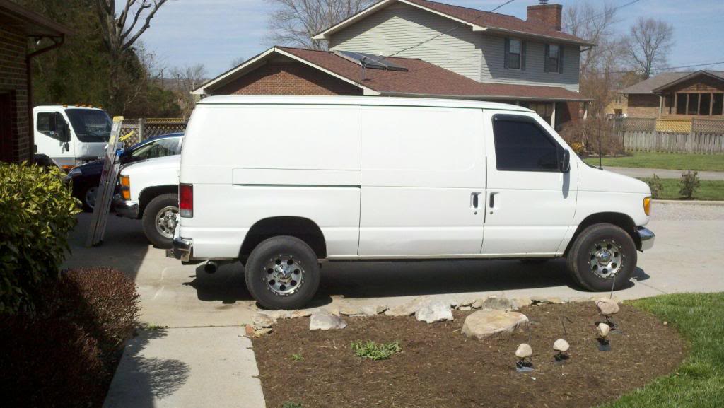

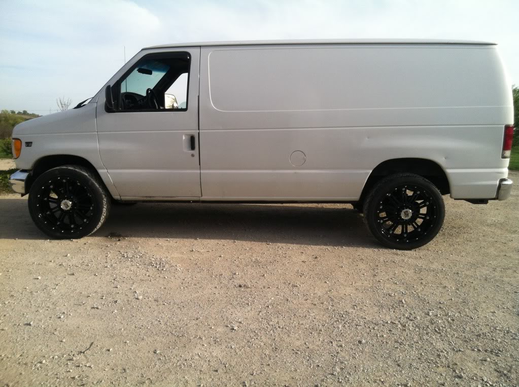

hi i recently bought a 01 E250 with a 7.3 diesel and the front end sits lower than the rear and im having trouble finding anybody to help me with some sort of a level/lift kit for the front. any help?
Size:  87.0 KB before
after new rims
Old Apr 11, 2012 | 06:53 PM
Welcome to the site. Nice van !
With coil springs up front , maybe a higher lift spring is available. Those 7.3's are heavy.
It almost appears that you have larger tires up front. Maybe it's an optical illusion.
Hopefully someone with more experience will offer more suggestions.
Old Apr 11, 2012 | 08:34 PM
greasemark's Avatar
Joined: May 2011
Posts: 717
From: Colorado, near Denver
One thing that not a lot of people know is that the front ends of gas and diesel trucks are the same. Even though the diesel engine weighs about 800 pounds more. Which means they wear out (really) fast. Look for sagging springs. You'll probably have to replace them, along with the ball joints and some other parts that wear really fast in this platform (things like the drag links, and tie rod ends). Not happy, I know, but it should help a great deal.
Old Apr 12, 2012 | 07:27 AM
Don't know if you want to consider replacing those front coil springs, but in 10+ years they had to have lost some lift power. you may even be able to get some variable rate aftermarket springs that may not give as soft a ride , but will hold up the front.
Old Apr 12, 2012 | 08:05 AM
twaltz401's Avatar
Joined: Apr 2012
the guy i bought it from gave me paperwork showing he put $1400 in the front end a month before i bought it so i think the front end is good. the tires are all the same size must just be the way the pic looks
Old Apr 13, 2012 | 06:37 PM
papabice's Avatar
Joined: Apr 2012
I think the rear looks high. Might check for additional springs in the rear for loads?
