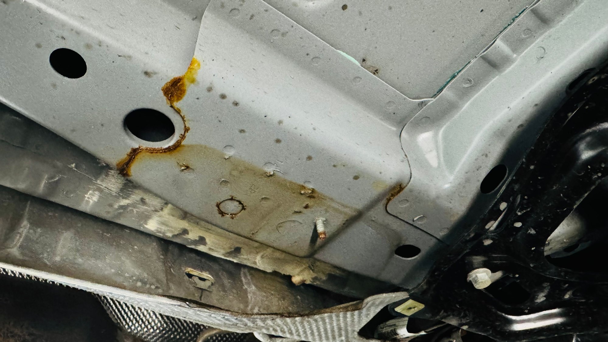

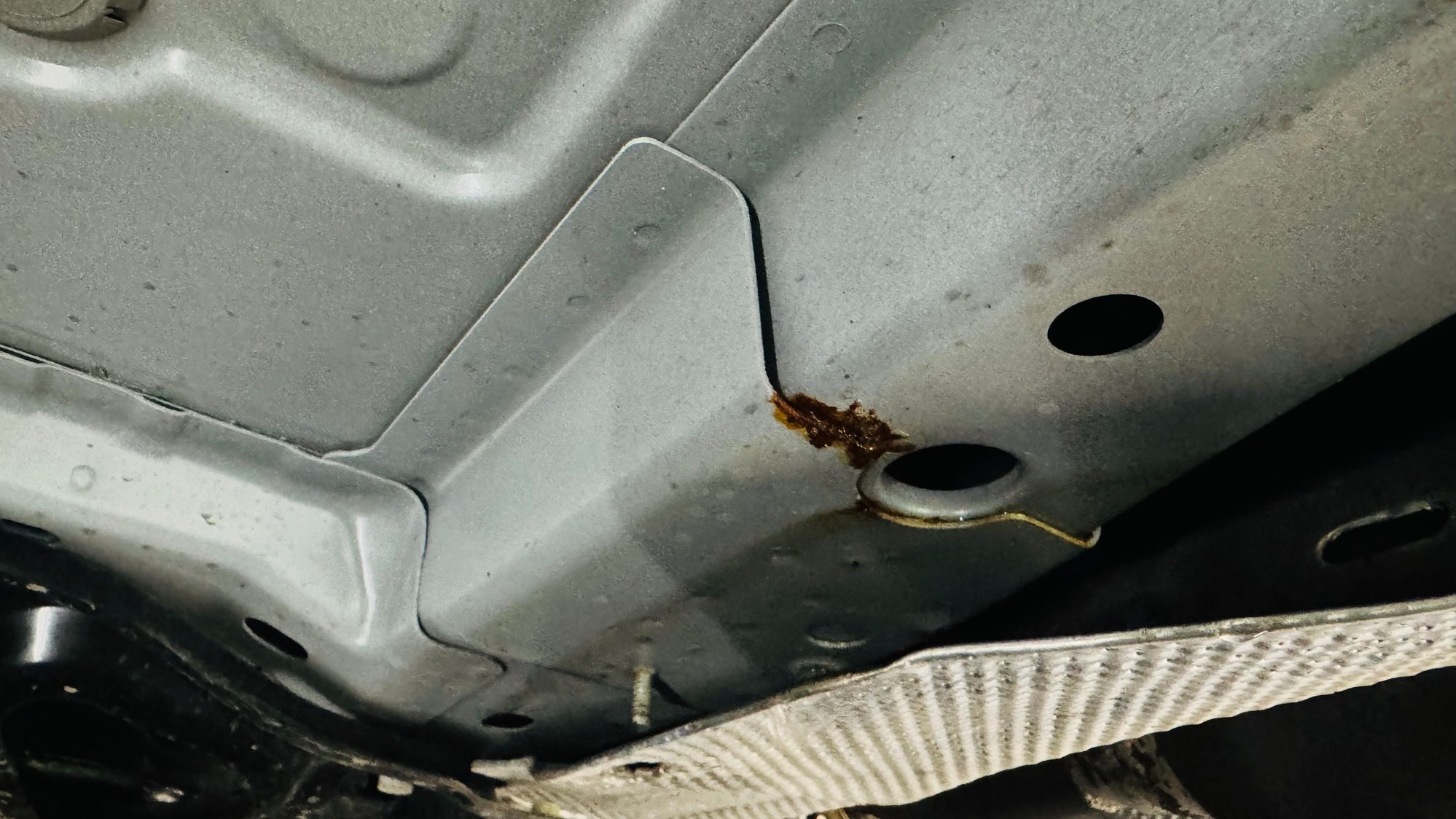

I own a Ford vehicle that has been regularly maintained and driven under normal conditions. Recently, during an inspection, I removed the factory-installed underbody shields and discovered significant structural rust underneath, including on chassis components that are supposed to be protected.

I understand that road salt and environmental exposure can contribute to corrosion, particularly in certain regions. My concern here, however, is more specific. The corrosion I am describing developed behind factory-installed underbody shields, in areas that are intentionally enclosed and not accessible for routine inspection or maintenance by the owner.
In addition, this corrosion occurred while the vehicle was still within the manufacturer’s warranty period, yet warranty responsibility was declined.
It may also be helpful to clarify that this vehicle is operated in a non-salted-road environment, where de-icing salt is not used. This is why the presence of corrosion in sealed or shielded areas was particularly unexpected.
My intent is not to dismiss environmental factors in general, but to understand whether the design and sealing of factory protective components could unintentionally create conditions that trap moisture or contaminants, potentially accelerating hidden corrosion even under relatively mild operating conditions.

Did you ask just what that shielding was supposed to protect ? I believe it is to protect the bottom of the engine from receiving damage if we run over an object in the road which could puncture the oil pan and result in a blown engine and not corrosion prevention.
The pix show what would be minor rusting from moisture which the shielding is not there to prevent.
If there is severe rusting , could you please post some pix of that, thank you.

Thank you for the clarification. I fully understand and agree that the primary purpose of the underbody shielding is impact protection rather than corrosion prevention.
I would also like to clarify that my concern is strictly limited to corrosion that developed while the vehicle was still within the manufacturer’s warranty period. If similar corrosion were to occur after the warranty expired, I agree that it would not reasonably be Ford’s responsibility.
What makes this case concerning is that the corrosion occurred behind factory-installed protective components, in an area not only covered by an underbody shield but also further protected by an additional heat insulation layer. These layers intentionally prevent direct exposure to road debris, moisture splash, and routine environmental contact, and they also make the area inaccessible for owner inspection or maintenance.
Because of this design, any corrosion developing in such a location during the warranty period raises legitimate questions about material selection, drainage, ventilation, or moisture entrapment created by the factory-installed components themselves — rather than normal external exposure or owner neglect.
I am not suggesting that underbody shields are designed as rust-proofing devices, but rather that when factory-installed protective and insulating layers unintentionally create a micro-environment that accelerates hidden corrosion, responsibility during the warranty period should be carefully considered.
I appreciate technical perspectives on whether similar issues have been observed by others, particularly in non-salted-road environments such as Taiwan, where de-icing chemicals are not used.
