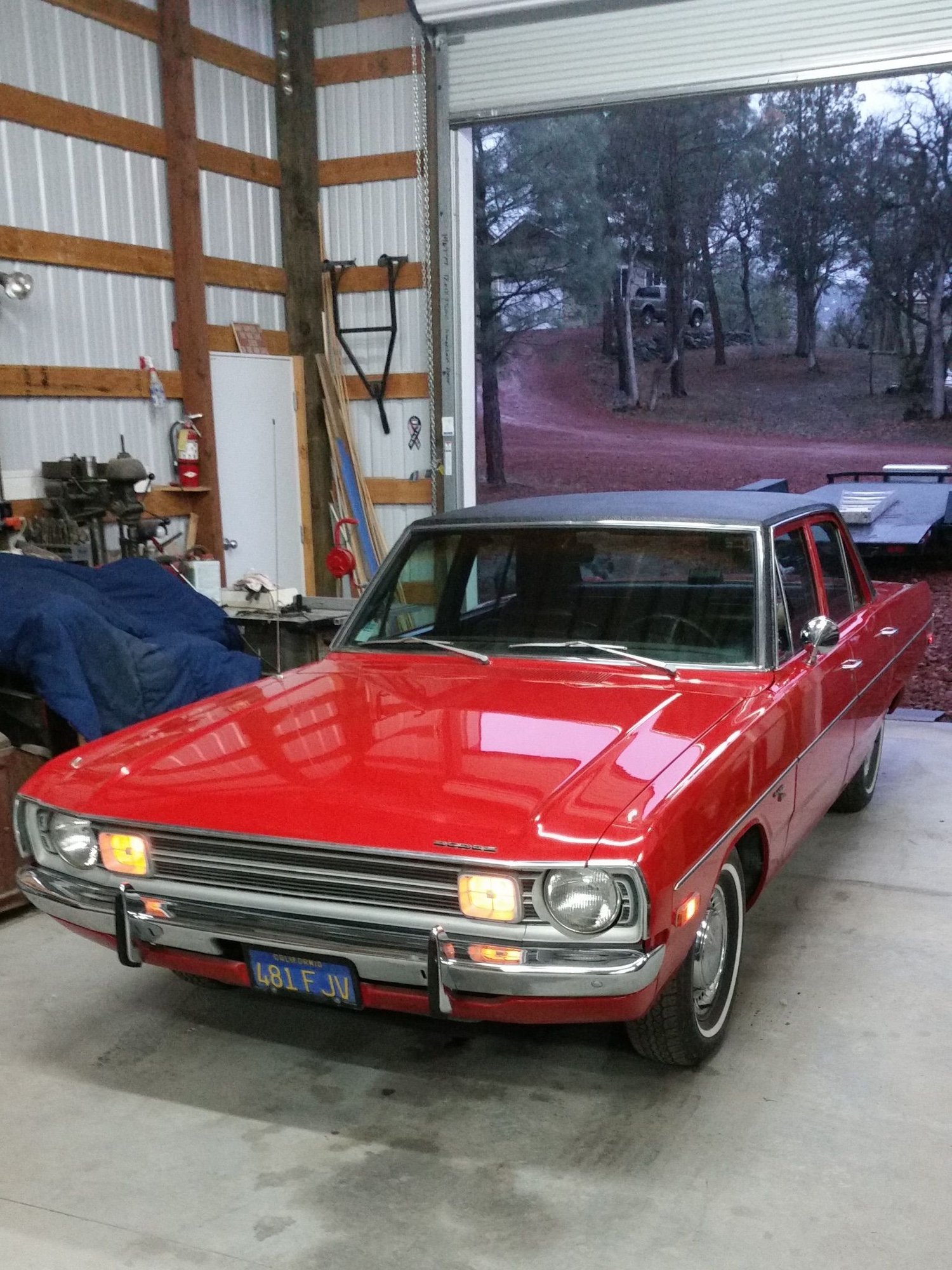

Thats why I asked,, I used Herculiner.
My 72 Dart had a lot of surface rust, not through rust but around the windshield leading edge where the top failed .
Took care of the rust, rollers applied the liner. When it set up, I blocked it down a bit to mimic the vinyl that was there. I then shot some low sheen black auto paint on top the liner.. Came out very nice. Other than missing the material seams, hard to tell..

Other then a paint refresh 15 years ago,, top about 3 ago, a few wear parts here n there,, all OE and untouched..
On the liner application,, after some blocking to cut the rough surface, painted, and re sand a couple times to smoooth the ‘look’.. Tough stuff, tenacious hold, easy to work with...
