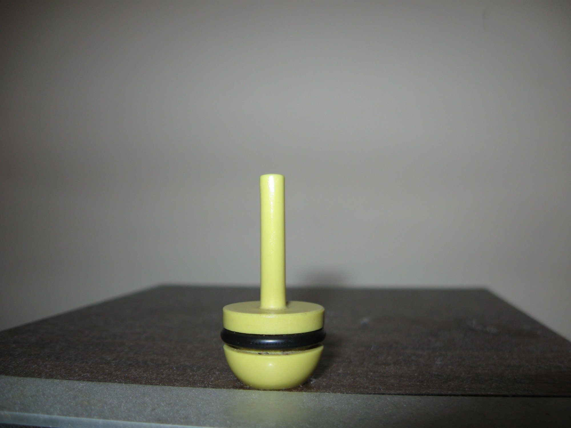

hanky and others.
This so called part is not a part
Jim at National Transmission in Lomita Ca, informed me that piece is used in the assemble of the 4r70w transmission.
he told me to throw it away.. no wonder the. number on it never showed for a part number..

Ford likes to do that, even the famous shipping plug that is found in the pan on the first pan drop. I wonder how many dishonest transmission techs charged for a repair because someone found one of these parts loose inside.
