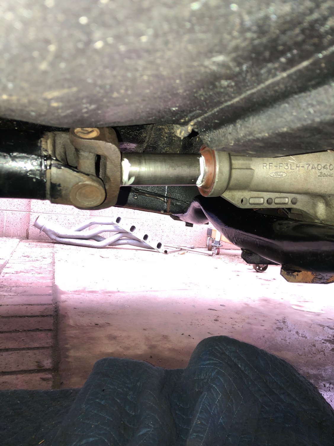

HI hanky, well I just took two on my Iphone 8 only thing is I can't find one of them... oh well
just reinstalled the driveshaft again.... NO way does it fit. it's easy 1.5" long... it did fit before I started ...
So why , what has happened or changed??
I have a pic of the shaft next to the Differential ... you can see how far past it is
I was going to try and remove the seal on the case, but that would ruin the new seal.. $$$
So let me ask this... When the yoke slides into the housing on the output shaft it only goes to the flange surface flush with the Dust Seal
correct?? The yoke does not slide past the bushing at all? This is nuts....
let me see if I can upload one pic
the one photo is the Yoke with 2 white lines drawn on it so you can see how much of the yoke is outside the case.. I do have a photo from before
I took the driveshaft out, but it's very dark.. flash I guess did not go off...

Keep in mind when the rear of the vehicle hits a bump and the axle assy rides up , the angle of the driveshaft changes and becomes straighter and increases in length and so that yoke must be able to slide in and out..
If the bushing accepts the yoke one reason you can't get it to all the way on is you must make sure the internal splines of the yoke must line up with the external splines of the output shaft so it can slide on those splines. From the pix, it looks as if you are at that point where you need to rotate the driveshaft carefully to have those splines line up or you will never get the yoke to slide on to on the output shaft.

I have thought about the spline situation... what is stuck in my mind is the ID of the bushing and the OD of the slip yoke
the slip is 1.572 OD before the shoulder the bushing is 1.606 ID I guess it should fit that 1" or so.... well I'll be under the car tomorrow

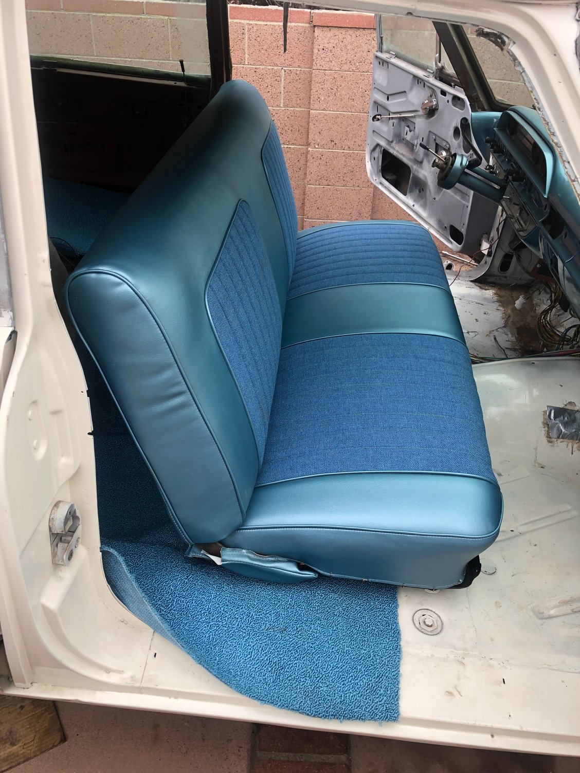

Any way since I working around the car anyway, I installed the front seat yesterday...
I went with the two tone blue, because I like it... I used cloth for the seating area, down the front of the bench.. so on a HOT day if I'm
in shorts I won't burn my legs or backside.. This car is the same one my parents bought in 1962... except this is a 9 passenger model
It's a 62 , with a 72 Cleveland and a 2001 transmission... talk about Frankenstein. sanded and repainted all the metal interior parts and I also painted the outside... it was "light blue" I went with Wimbledon White, which is a historic color for Ford.

Is there any chance that the drive shaft is just to long? The total amount of shaft inside the hosing is only about 3"...

There was no magic involved, I just realized that the angle of the slip yoke was not parallel to the output shaft... that's all and the slip yoke
was catching on the lip of the bushing. Never had it happen before, but there is always a first time..
Take care all, Best
