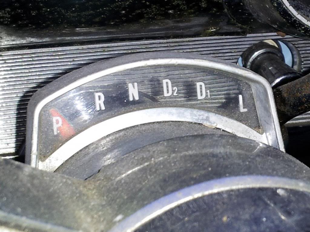

I had the 390 FE built in a 1964 Mercury Monterey. Among other things, a 292 / 560 Comp Cam was installed. I'm pretty sure that the Lying Crook mechanic that did the work did not put a new stall converter in. He's waiting to see if he can get away with it. My question is about the C3 transmission. I have read that that start off in second gear when in D2. Is that true? When I drive it I shift from L to D1 and nothing happens. Then shift to D2 and it changes to a higher gear. Is it not going into low or 3rd? Is the new Cam causing this , only 2 speeds? It also jerks hard and wants to die when shifted into reverse or Drive. Can a modulator valve cause a missing gear? I never drove the car before the engine was built so I don't really know how it should behave. Any information would be greatly appreciated. Here is a picture also.

Yes it is true , when the shift selector is in D1 it starts in 2nd gear. They were great for starting off in snow. I believe the low band is applied and it will stay in low all the time whereas in D1 if the speed is high enough it will shift to third gear .

Yes it is true , when the shift selector is in D2 it starts in 2nd gear. They were great for starting off in snow. The difference between D1 and Low is you get a little more OOMPH because in low I believe the low band is applied and it will stay in low all the time whereas in D1 if the speed is high enough it will shift to second gear .
On mine, there is no difference between Low and D1. The only change is from D1 to D2. It seems that the RPMs are too high in D2 also. I just put a Tach in it last night and haven't driven it yet to see what it is at about 50 MPH. I'm also going to pick up a modulator valve today and see if that does anything.
