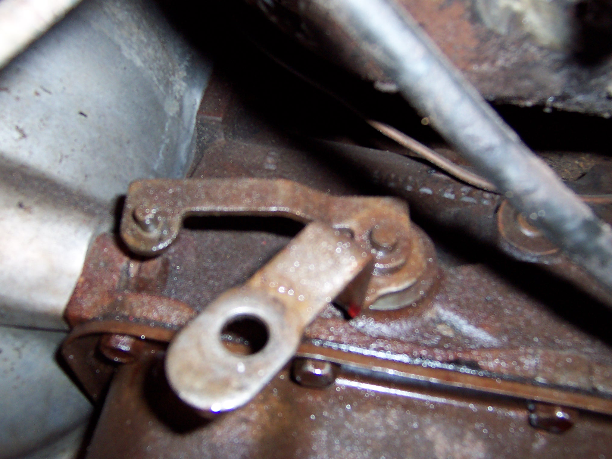

The seal is leaking behind the control lever. How do you remove the levers to change out the seal?

The pan needs to be removed , then you can get access to a retaining clip or nut on the inner end of the shaft. Then that shaft can be removed and the seal pried out . Installation is simple , just coat the outer surface with some RTV and install . You can use a socket to drive the seal in.Then just reassemble the shaft and inner link and tighten the nut. I believe there are flats on the shaft that line up with the arm inside, no big deal. While you have the pan down might be a good time to replace the filter,seal and pan gasket. They all come with a filter kit. No adhesive or sealer is used to hold gasket to pan.
