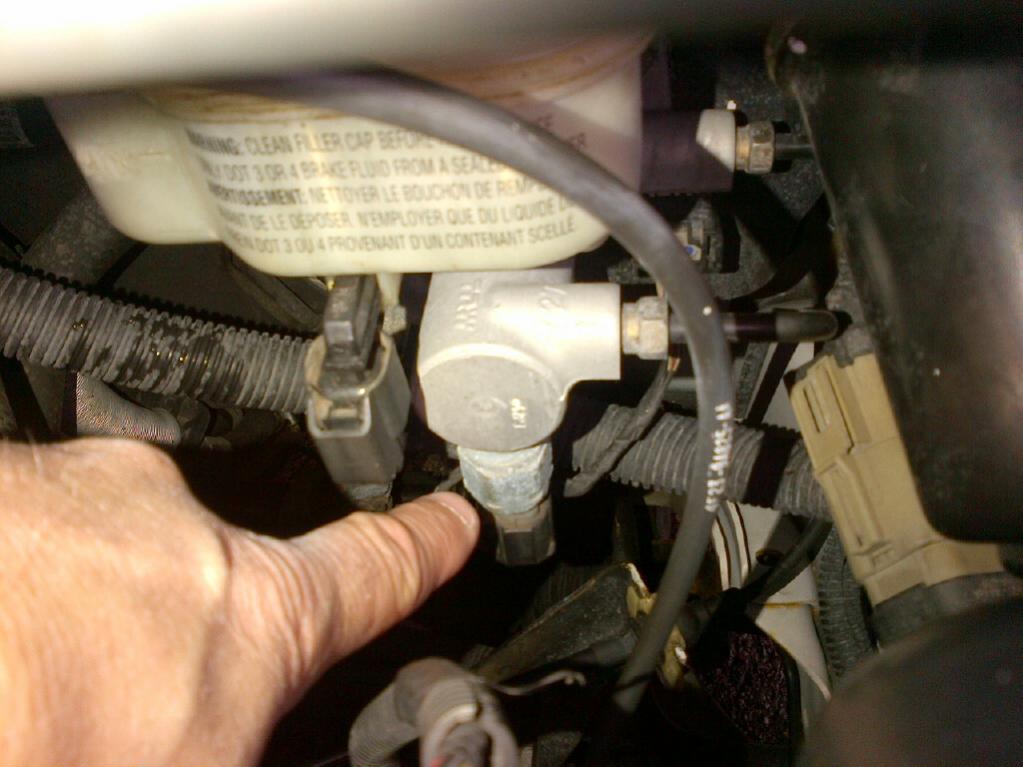

For your ABS/Traction Control issue, I would look at the BAKE PRESSURE SWITCH. Cheaper and easier to do. Just disconnect the connector, unscrew the old one and install the new one. Don't worry, brake fluid will not run out. It is located where my finger is pointing in the picture. It cured my ABS/Traction Control issue on my 04 Freestar. I know that there were issues with the ones leaking on the Windstars with some associated with a recall. I would also check the wiring harness connector for ABS ECM module if you had brake fluid leaking down on it.

is there something else that that sensor might be called i have called all over trying to find that sensor but noone can figure out what im talking about when i call, they all keep saying im talking about an abs sensor. autozone, advanceauto, napa.
lol. im thinking i may have to take the sensor off and get a part number and call the dealership to get it.
where did you get it at?
No, take the van there and point your finger to it. Or go to RockAuto.com and search yourself.

Not sure of the part number for the 2001 Windstar. The part number for the 2004 Freestar is Ford part number is "7F2Z9F924A". Your local Ford Dealer should be able to provide you the number and price. Mine was only about $32-35.

ok so after looking under the hood to check for the brake sensor, its brand new. i called the dealership where i had the front subframe replaced and all the extra support brackets installed at. and they said that when they looked up my information that they had replaced the brake pressure switch, and the abs computer.
