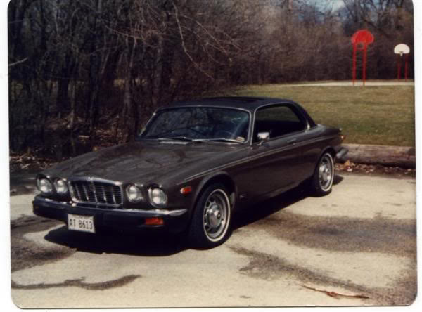

Anyway as they said about my XJ-12C Jaguar, ANY temp is fine as long as you do not loose coolant. Many times I have pegged the gage when sitting in traffic on Edens Expressway in Chicago. It gets so hot under the bonnet a box and cooling fan sits around the battery and the power steering pump is fitted with a radiator. And that's with an iron block and aluminum heads with wet sleeves.
