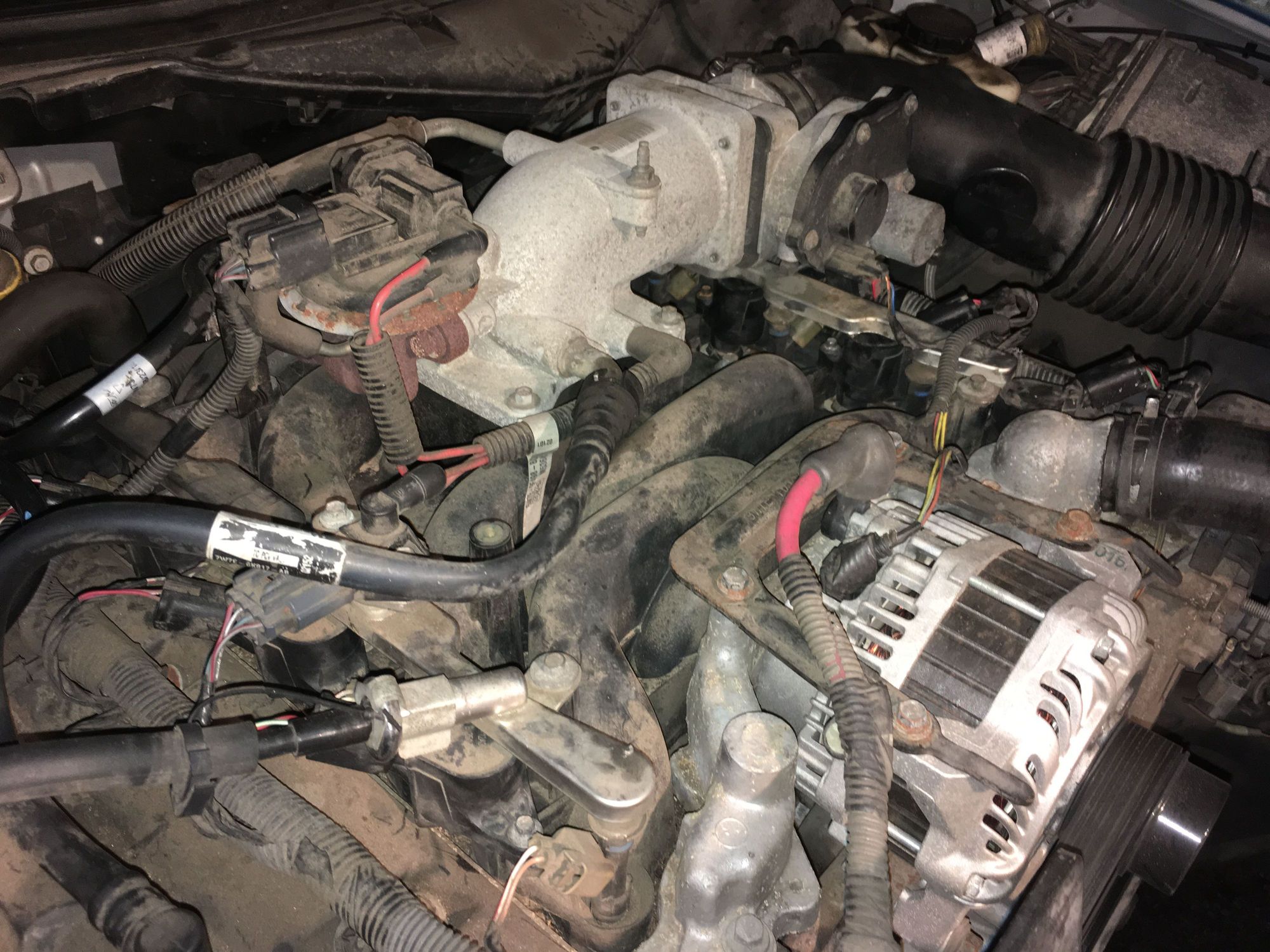

I think my setup is a little different than the engines in the youtube videos I've been watching. I don't have the throttle cables and ports on either side of the aluminum part of the manifold..

To my surprise the manifold I unboxed didn't have embedded gaskets like I'd seen in all the videos. Mine came looking like this..
I assume this would be the version that requires a separate gasket. Unless there's better advice I'll prob just go with a Felpro.
Actually, should I just return this one and get the embedded gasket version. Someone mentioned the seal on that one would probably never go bad.
