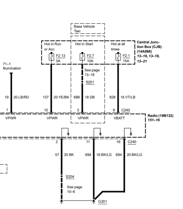

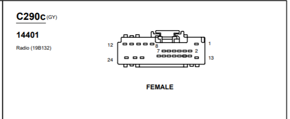

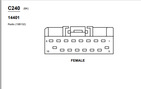

Here is the power/ground diagram for the crown vic. Check if there is continuity to the correct battery terminal for each of the pins.
The first picture is the base radio diagram. The second picture is the Alpine radio diagram. The third and fourth pictures are the connectors in the diagrams.
You should be able to look at the factory radio connector to determine which radio you have. I would assume cop cars have the base radio but cant say for sure.
