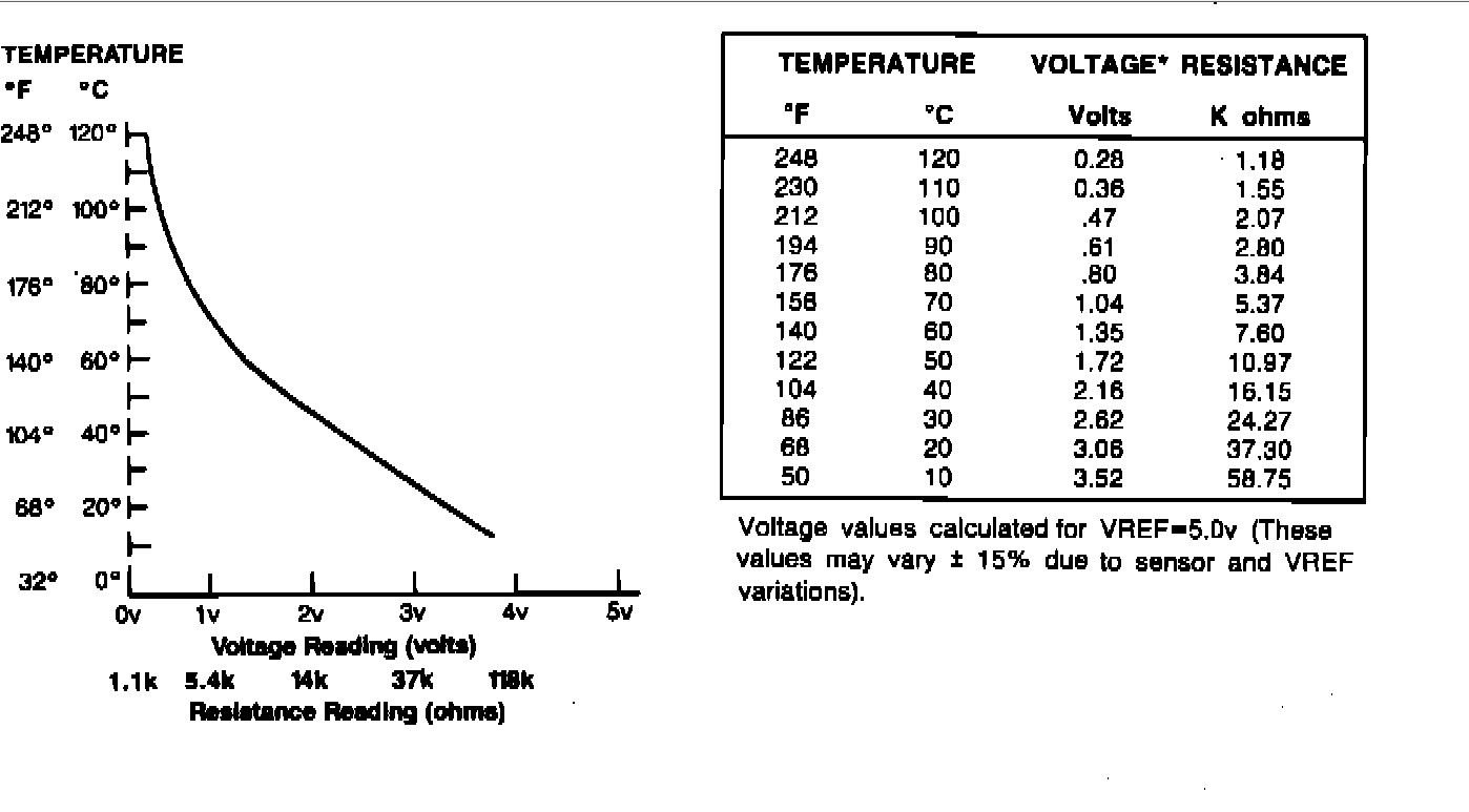

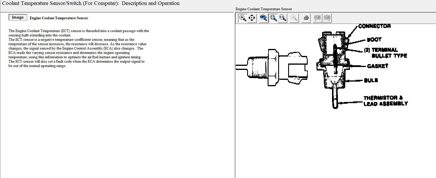

You already replaced quite a few components. Have you checked the most overlooked component: Engine Coolant Temp Sensor (ECT) yet?
Test the voltage and resistance first, don't just replace the sensor.

That coolant sensor is for the PCM, not for the gauge, that's why on the pic you see "for computer"

What does a PCV valve do you can search google easily and it's easier to replace. When you remove the old one be sure to shake it. The ECT is not difficult to replace but the coolant is going to spill when you remove the old one out. Even if you don't want to check the voltage and resistance you should remove just the electrical connector and clean first. The corrosion can cause false reading. Also don't forget to check your coolant level once a month. When it's low it can cause more problems than just your AC.
