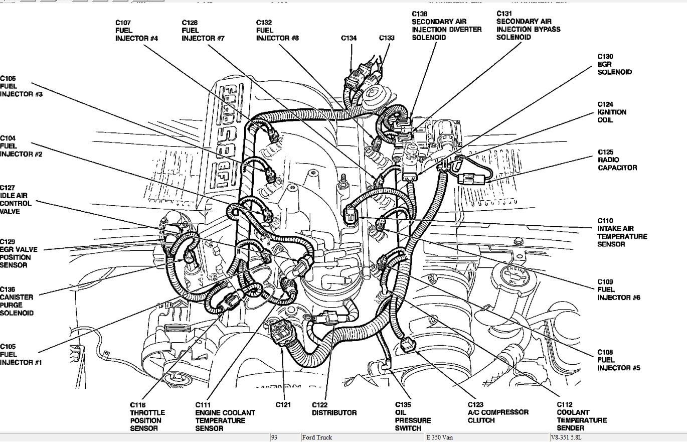

1993 Ford E350 with a 5.8L V8. Looking at the motor for the first time since buying it. Already replaced some rotten and broken vacuum lines. I saw this line disconnected and need help identifying the solenoid it comes from and where it needs to be connected. Additionally... working on a van sucks haha!
Any insight would be appreciated.
Josh
Backside, driver's side valve cover
Pink or red line

Yes, you are correct. Do not know where my brain was. Thank you for the diagrams. Just knowing what it's called is a huge help!
Josh

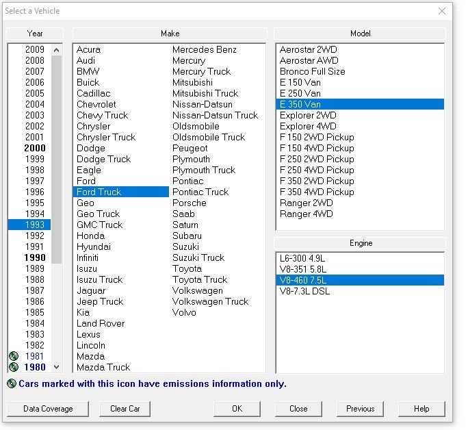

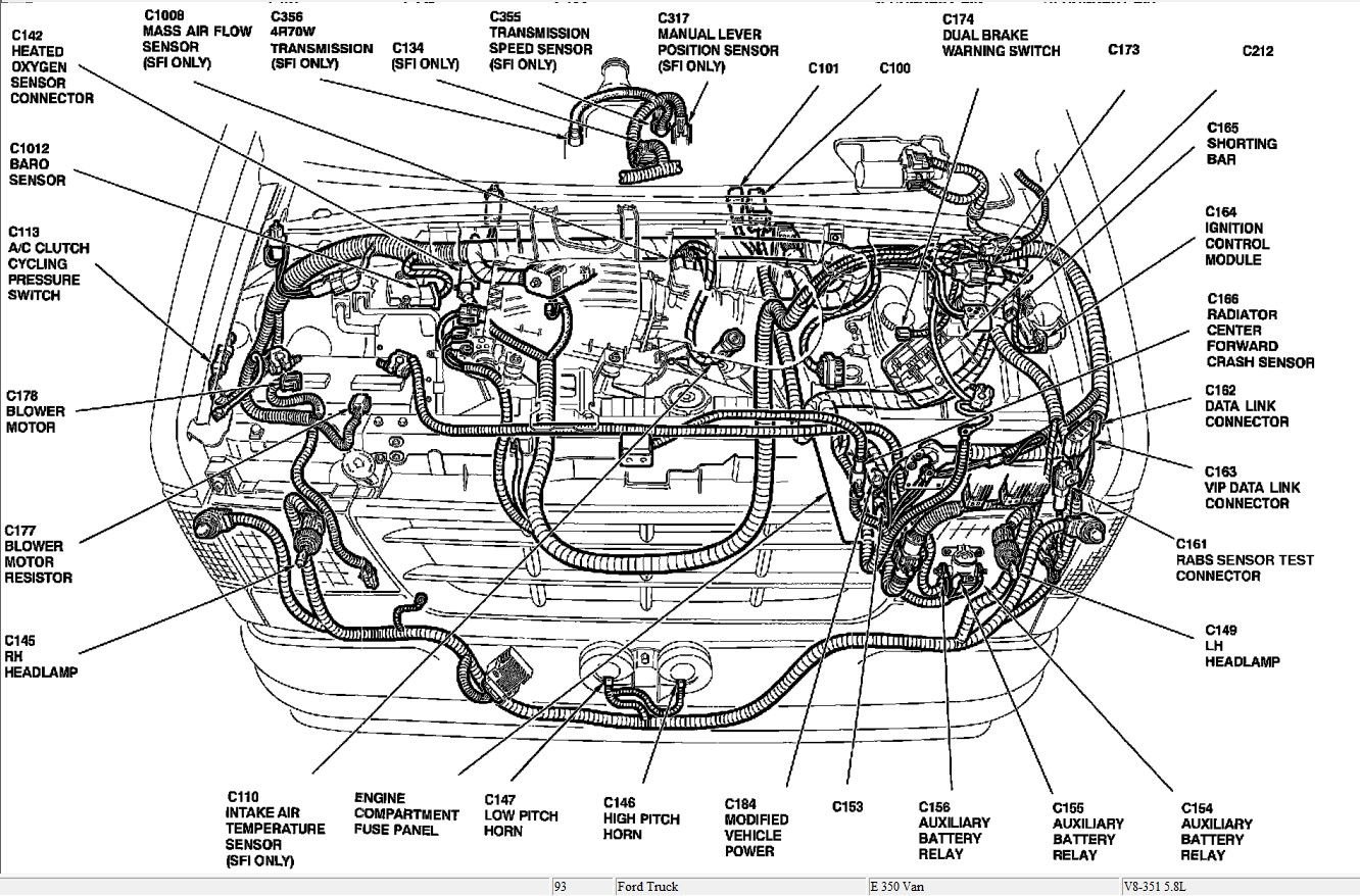

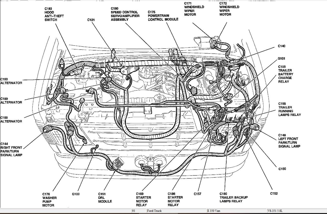

Below is what's shown on 93 E350 on my alldata software.
Find below the vacuum diagrams in pdf I didn't attach previously. But I think the full engine diagram is easier to read and follow.
