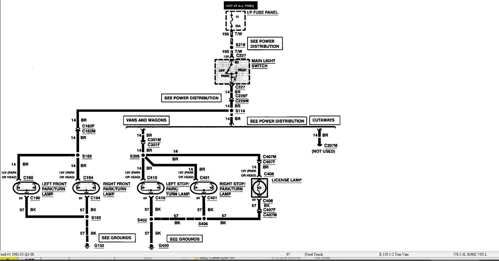

Diagram above locate circuit 14 (BR) wire that's the parking light, including front left + right, rear left + right and license lamp. If you don't have rear parking lamps but you have license lamp and front parking lamps working then you don't need to check on the 20A fuse, that means there is a break somewhere, perhaps at S306. Since you never mentioned your license lamp working or not, also check C301F/C301M if your license lamp is also not working.

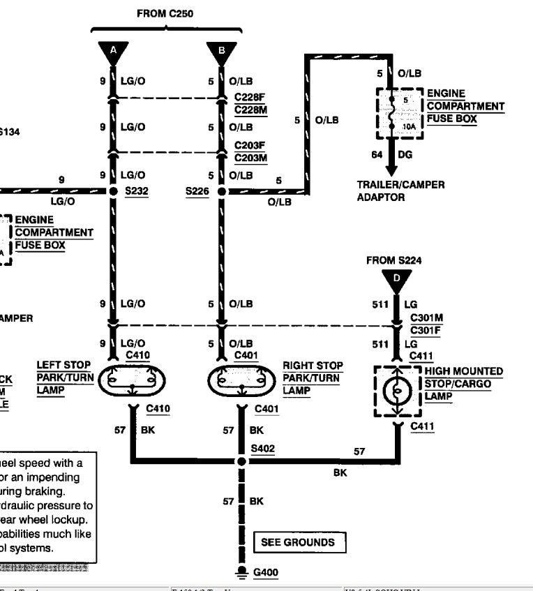

Diagram below is for the brakes and you said they are working fine, so this diagram is for reference only, you can see circuit 5, 9 and 511. You can see circuit 57 (BK wire) are the ground for both, and when your brake lamps are working, you don't need to check the grounding.
