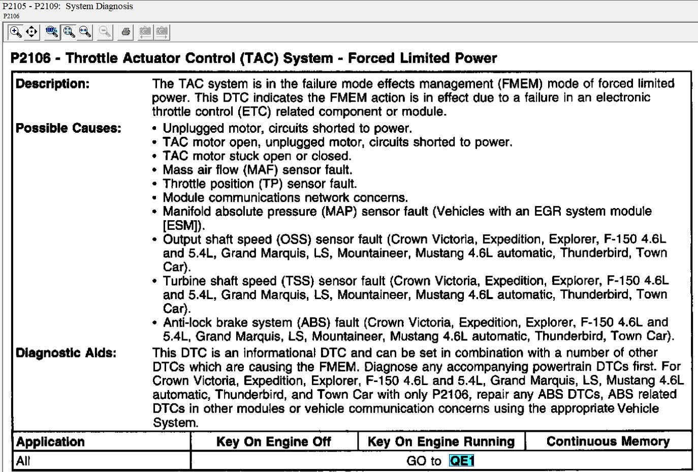

From what I’ve read, P2106 seems to be a “forced limited power” code triggered by another underlying issue, not necessarily the throttle body itself.

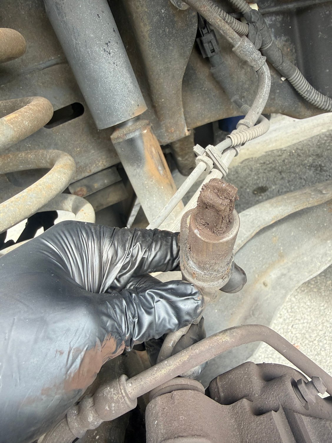

yes, I do own a Foxwell scanner, I disconnected the MAF sensor and let the car idle and it died, it seems to be whenever it reaches normal temperature is when the car decides to stall. The wrench light was on when the MAF was disconnected. It also had a abs code for the driver side wheel speed sensor and the p1000 self test code.

QE12 mentions about reference values, check attached below.

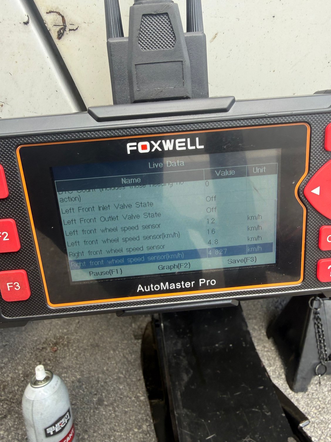

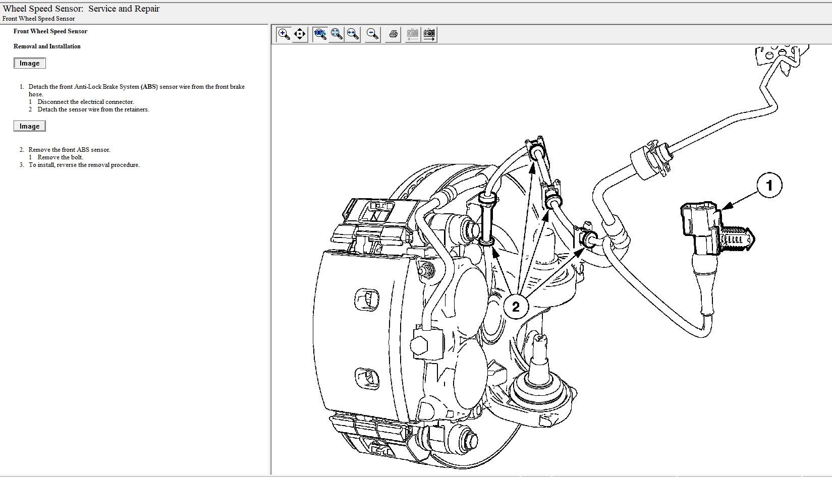

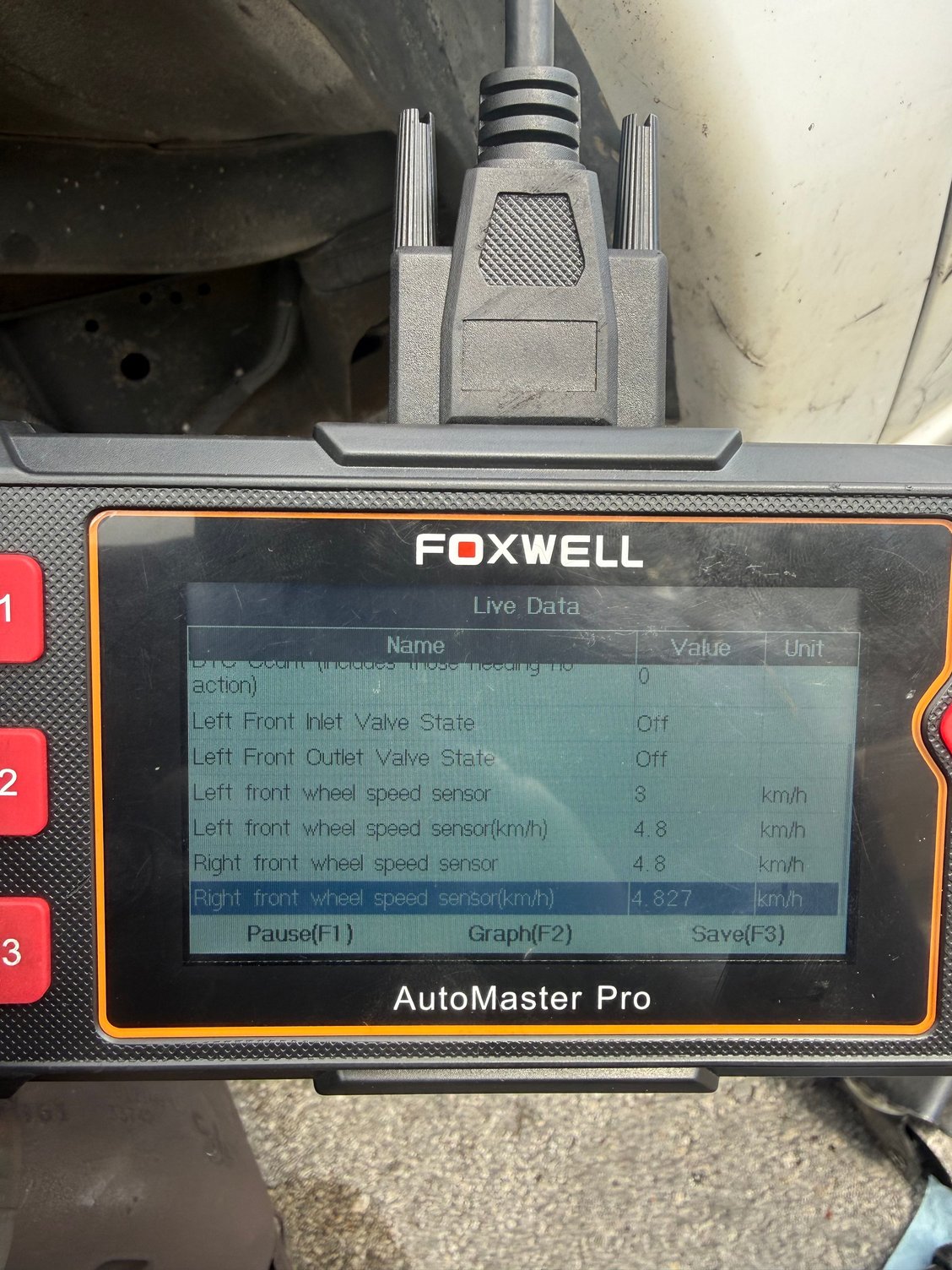

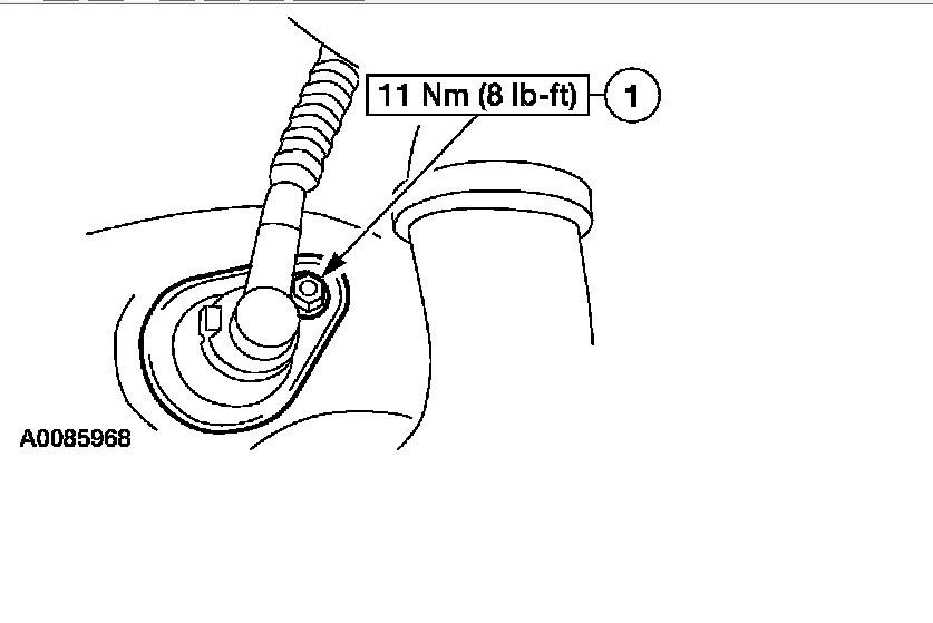

You mentioned about ABS code, which DTC code exactly so I can attach the pinpoint test. You have foxwell you can get to ABS module and select live data. You can even jack and elevate the front? and you have 4WABS right? (instead of RABS), you can then spin the wheels by hand and check your live data on foxwell. And of course, remove the sensor and clean first. If you check P2106 shown above, ABS fault could be one of the possible causes.

so I was able to do I did not take on the wheel speed sensor. It was super dirty with a lot of metallic dust. I did not do a reading prior to cleaning the sensor, which I should have done, but after the fact, this sensor reads similar to the right-hand side. Please see the photos attached one is going to be with a tire stopped. The other photo will be reading as I rotated the tire. I also did a video of every other sensor. My scanner could read in the car, it is about three minute video. I will appreciate if you want to go through it and see if any of those values are out of range.
