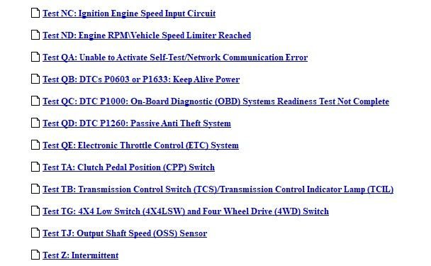

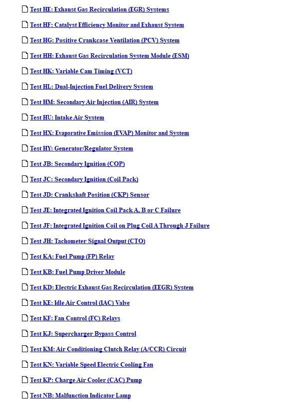

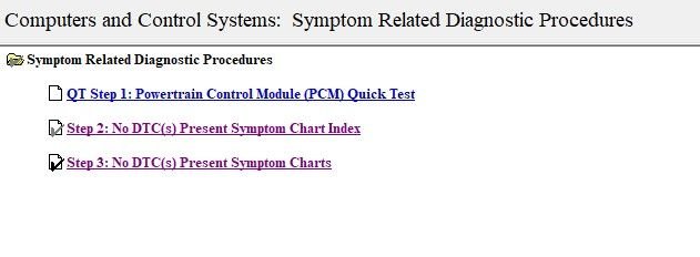

If you go back and check on P2106 there are 10 possible causes, When MAF connector is disconnected there is a factory default value and it shouldn't stall the engine anymore but it did so you an rule out MAF's fault. Further if MAF is at fault you would get more than just a P2106.
Let's take different approach so you can test the other sensors as shown below:
