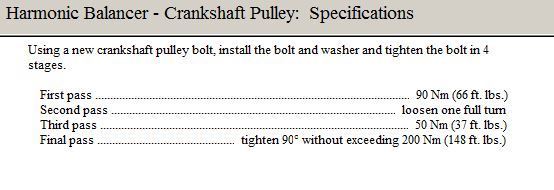

I have to replace the Crank Pulley/Harmonic Balancer on this E150 due to rubber separation. I cannot find any videos specific to this vehicle. Pulley and balancer is one piece. Suggestions? Special tools?

I believe something is not right with the drawings and item descriptions.
Might want to recheck.
This is what should be considered when replacing the crank pulley,
Take your VIN to a dealership parts dept and engine certification info if available on one of the valve covers and with that info you should get the CORRECT crank pulley and bolt.. The reason for doing it this way is, changes are made from year to year and sometimes mid-year and only FORD knows all this info.
It is critical to obtain the correct pulley since timing can be affected.

I've replaced enough water pumps and if I recall correctly, lol, you will need to remove the fan shroud too.
It is a little tight to get the bolts off that hold the fan to the water pump. Make sure you mark the fan blade so it goes back on blowing in the right direction.
If you remove the 4 bolts that hold the fan clutch to water pump, job gets a lot easier, fan, clutch and assy come out all at once.
The job can become a PITA if you don't have the right tools to remove the old pulley from the crankshaft..
It is always a good idea to lay out the parts you remove in some order so you install everything in the right order. That way you can concentrate on what you are doing instead of trying to remember everything.
You should use a pulley puller tool or you can wind up wishing you never started the job.
If you were my customer, I would suggest you replace the water pump while everything is apart if it has never been replaced before. Don't know miles on it, but if original,it has been on there for approx 18 years and you don't want to do all this again,,,or do you ?
I forgot to suggest you make a diagram of how the belt is routed if there is no diagram in the engine compartment.
A little tip, place a piece of cardboard against the radiator so you don't damage the fins and interfere with it's cooling ability, saves your knuckles too !
