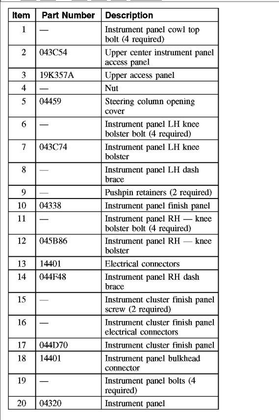

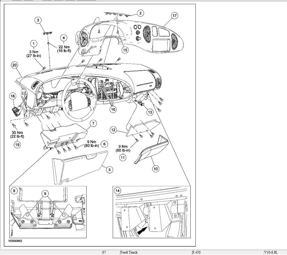

Remove the dash so you can see better. My alldata covers up to 2007 for your reference.
Never rule out it is leaking from the roof thru a-pillar, so check Headliner-Removal.pdf too.

Thank you for the reply and info. I wasn't thinking the dash board would need to be removed, but that makes a whole lot of sense as it would provide the best view. Briefly looking over the documents you provided is kind of overwhelming at this point, I've never removed a dash. I need to keep studying the process, build up to it, and plan ahead. I'm kind of leaning toward the windshield being the source of the leak, but I've gotta know for sure.

Yes remove the dashboard and headliner and a-pillar then you have a clear view. You can also pour a liter of unsweetened coffee or tea, you might not see the darker color water leaking till tomorrow or so, that means you have water buildup somewhere when you see clear water still. Try not to use ice or hot water for testing, you may crack the windshield when doing so.
