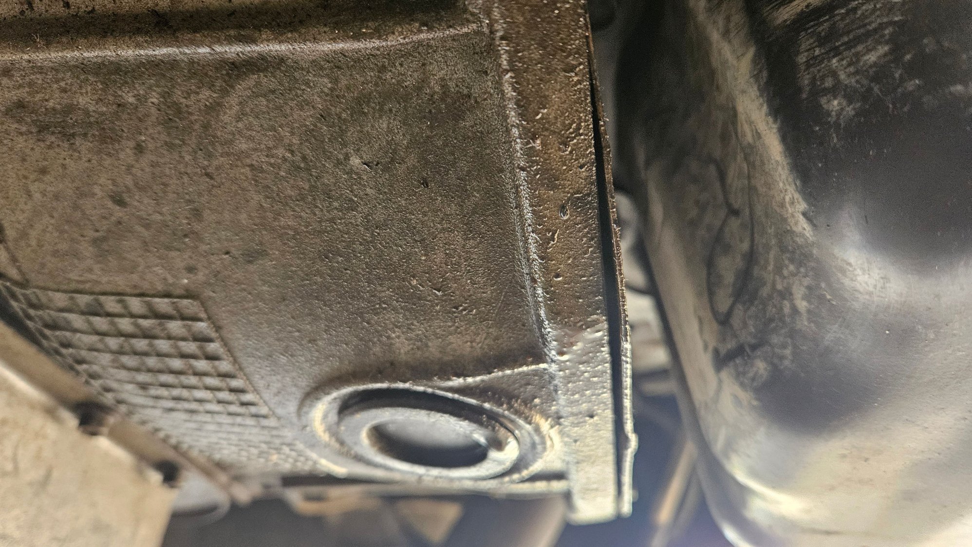

So I've been trying to start my engine It's always a no crank no start, just one click and it doesn't even sound like the starter motors engaging, finally got into my cylinders and they were full of some kind of liquid. It was nasty there was green, I had to have a friend come over and show me that I just needed to put muscle into turning the crankshaft by hand and that if it's nearly hydrolocked or hydraulic you have to go counterclockwise to get it to move. So I did and And I began to try to clean out all the crap that I used to try to unseize it when I had no idea what hydrolock Even was. But I can only get it to turn a few turns and either direction before it hits a major resistance bump. Mini I can turn it pretty freely but then it gets to a point where I feel like I can't turn it at all. Goes in both directions and I'm wondering if this is like a timing issue or if there might be damage done from trying to start it several times when it was like this.
It's been sitting in a driveway for over half a year and it has not been driven and I don't know how long but how it got fluid in the cylinders I have no idea I suspect it might have been something to do with my vacuum and brake booster system because of the fact that I don't use green coolant.
And I'm about to try to turn it over with the starter motor with everything disengaged and unconnected just to see if I can get it to spin otherwise I feel like I might have had some major damage done and it's probably dead. But I'm really hoping that if I'm correct because of things like a camshaft position error sensor and several other mistakes that were just stupid to make like forgetting to connect a fuel injector when trying to start it for instance just little things like that here and there I imagine over time would cause errors. Like misfires or something like that just adding up over time I don't know how it works exactly if that's something that's plausible or not but I'm about to just jump the solenoid and see if I can get it to start or I mean turn over so that way I can fill it back up with oil and put it all back together and hopefully have an engine that works. There's this one problem. That separation there is making me nervous. I don't even know how the torque converter might come into play but something tells me it might.
Separation of the plate from the torque converter itself I mean I know I can pop open that cap and access it and even turn it if I want to but I don't know what the consequences are of that or if they're supposed to be a gasket there or anything of the sort. My guess is that since it's completely and totally rusted looking inside it's not good, I don't know if that's normal or not but I don't think it would be.

First , that rubber plug is there to gain access to drain the torque converter when servicing the trans. Road salt and moisture can get in there and cause corrosion not a serious problem.
