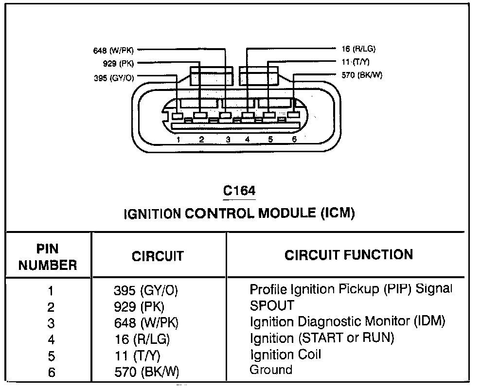

Sounds like fuel delivery or ICM / TFI.

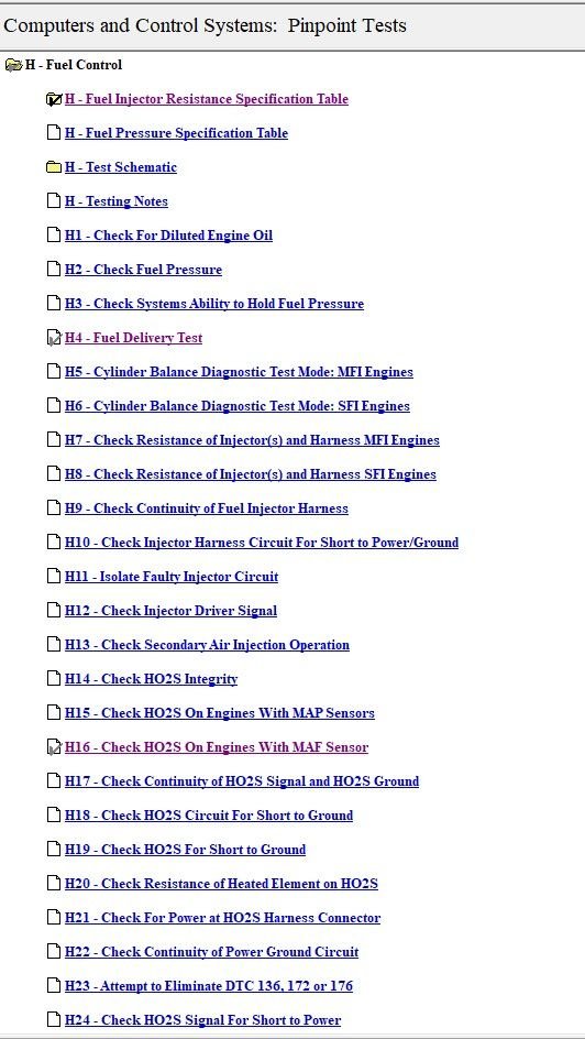

Pinpoint-H index page shown above.
When was the last time you change the fuel filter? Go thru pinpoint H and do some tests.

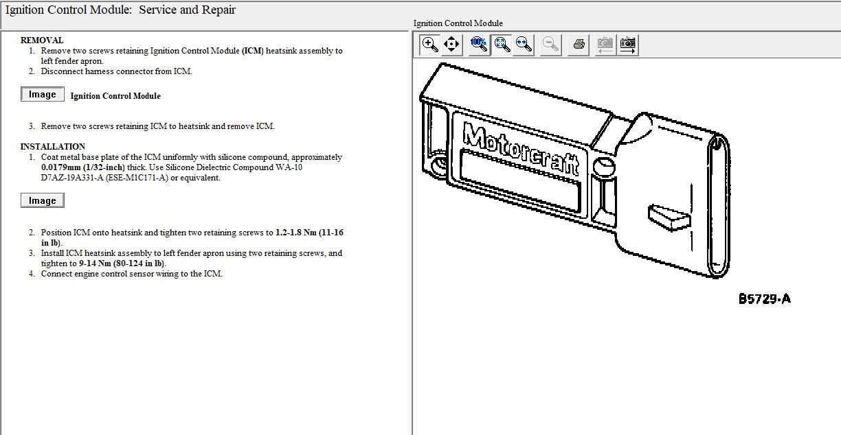

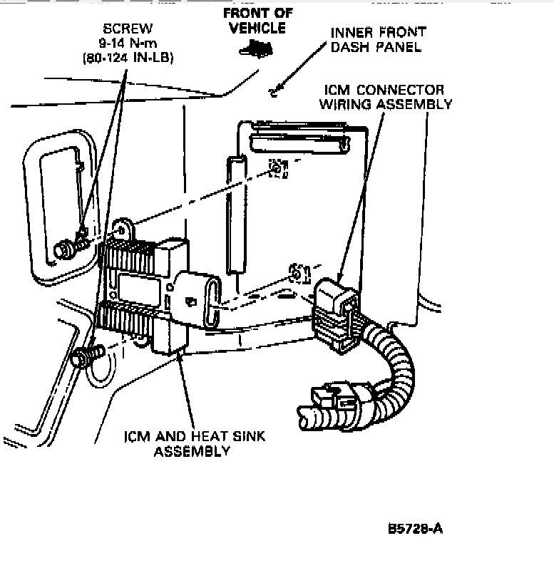

Below here is for ICM. And ICM relocation has been discussed a dozen times here.
If you have any spare desktop computer case fan laying around you can hook it up to a switched power (control by ignition switch) and blow it toward your ICM and zip tie it. If you have another fan then attach to it and suck the heat and blow away from your ICM. Ideally you'd need something like thermal pad in between but for quick diagnostic purpose you don't have to.
