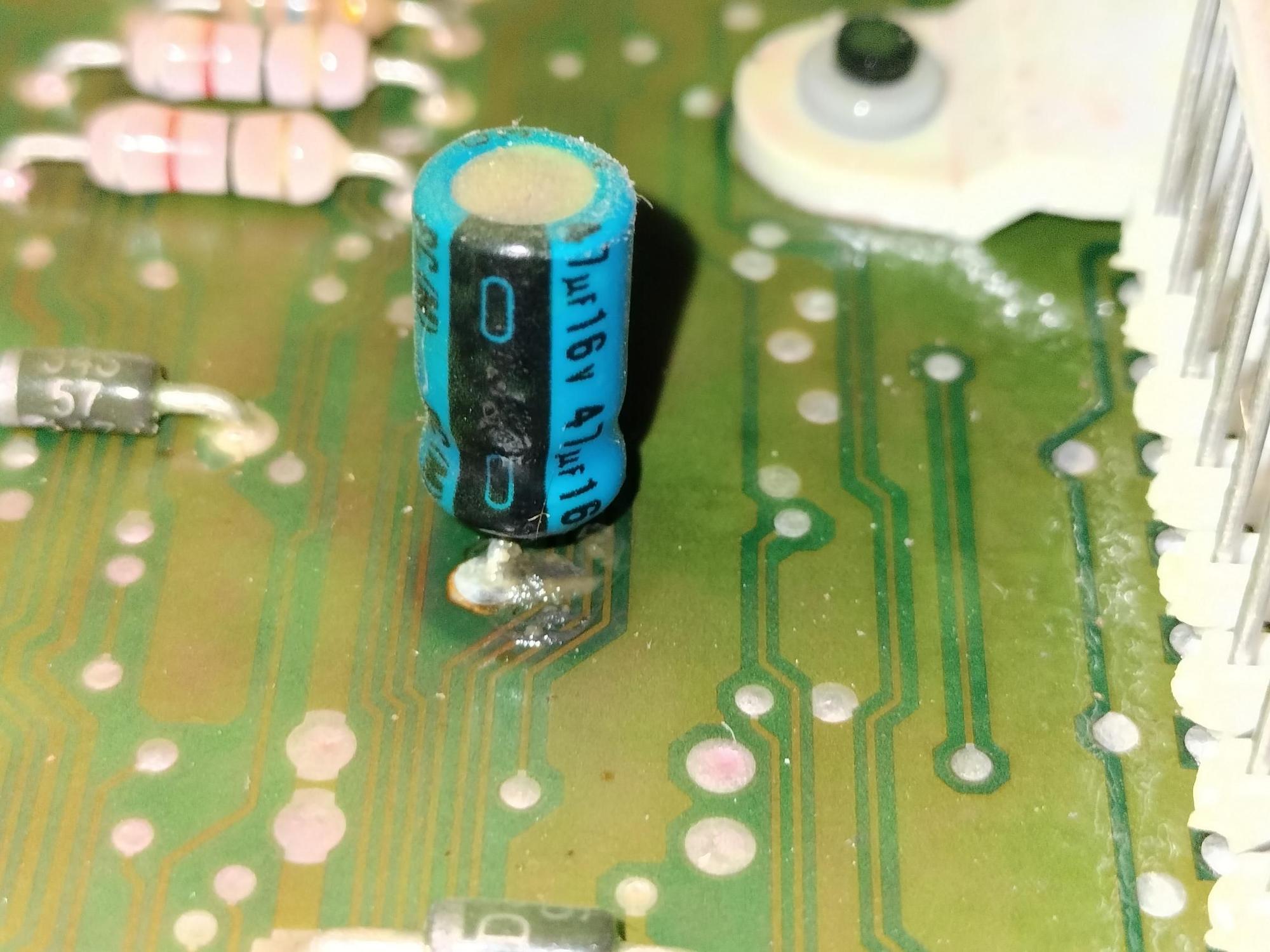

Found it and got it out. Got some bad looking capacitors. Sorry about the size.
