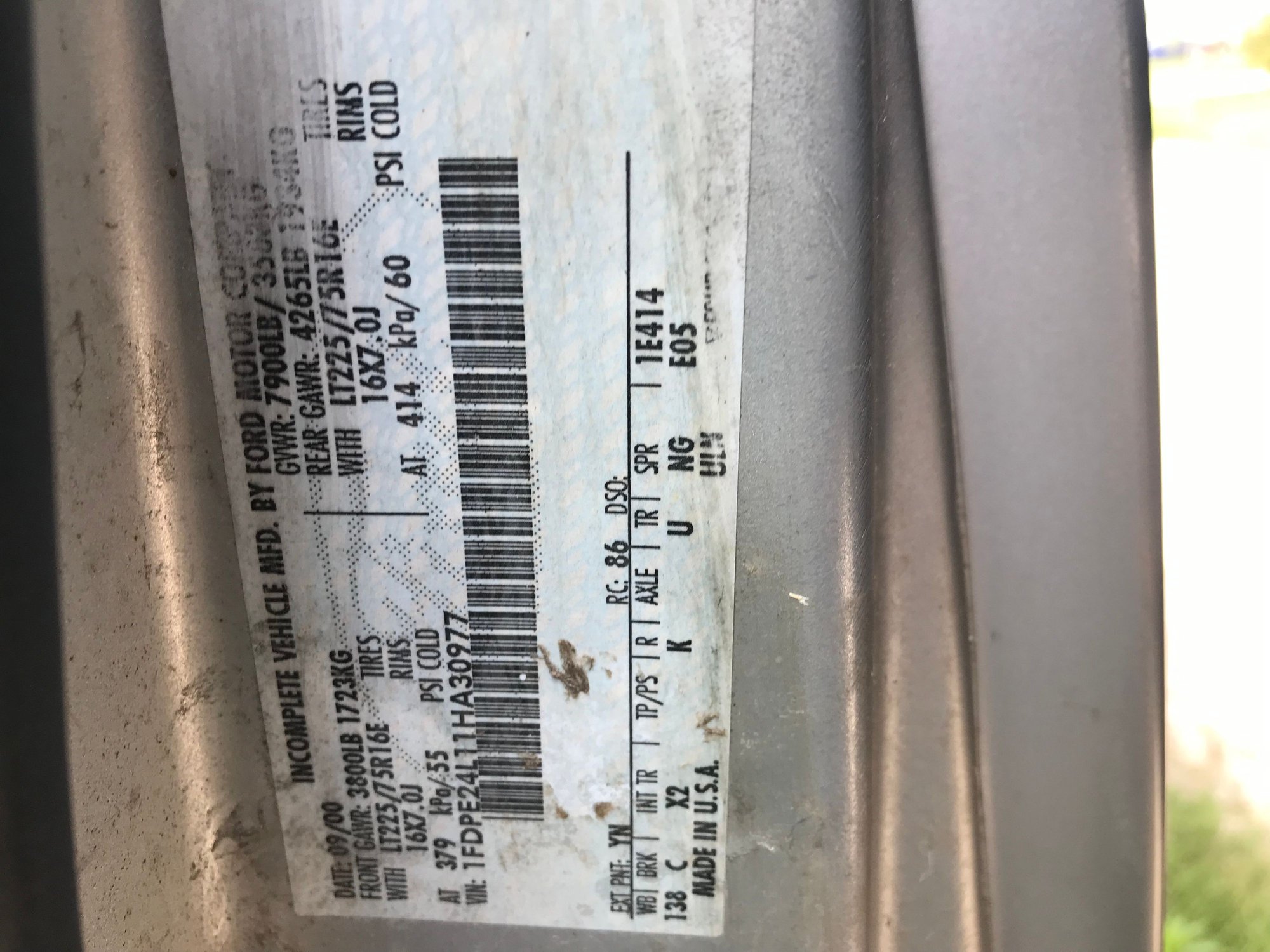

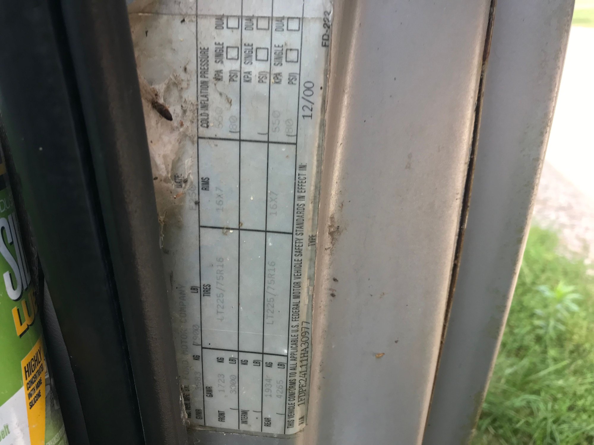

these are ALL and the ONLY stickers on the drivers door

It appears your vehicle has a 4R70W trans.

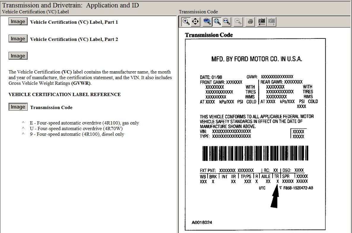

Old Aug 10, 2025 | 10:30 PM
  #28
Posts: 1,229
You have U on yours so according to the code shown above you have 4R70W.
When it comes to ford E/F series, NEVER EVER rely solely on what's shown on the door jamb tag when you are not the sole owner of the vehicle. You count how many bolts on your tranny pan to get definitive answer which one you have.
4R100: 20 bolts
4R70W: 14 bolts
