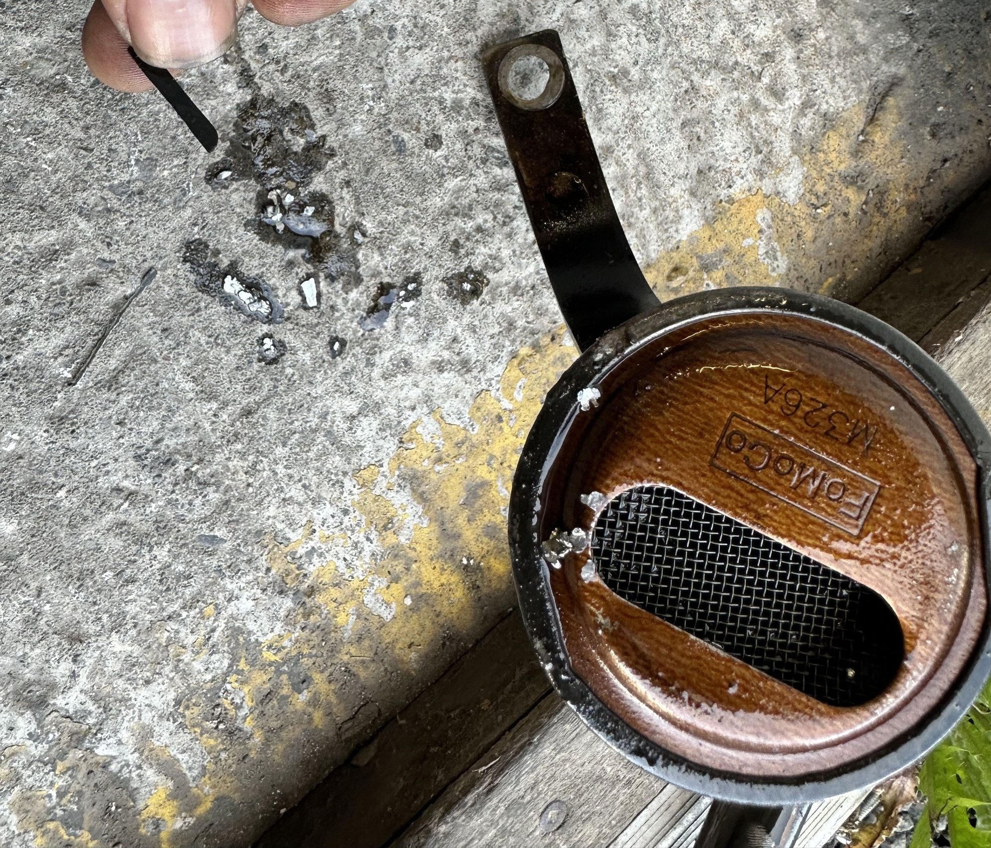

I drained the oil and open up the oil filter and could not find any broken piece , Then I took the oil pan off and could not find any broken piece except the little plastic piece and few silver tiny metal on oil pickup screen ,
I have a hard time to take the oil pan off (why Ford makes like this) , but I looked at crank shaft and looks like some one used 40 greet sand paper and scrub it , Please take a look at pictures and let me know , I am still hoping we can restore the engine

Can you please look at the pictures
