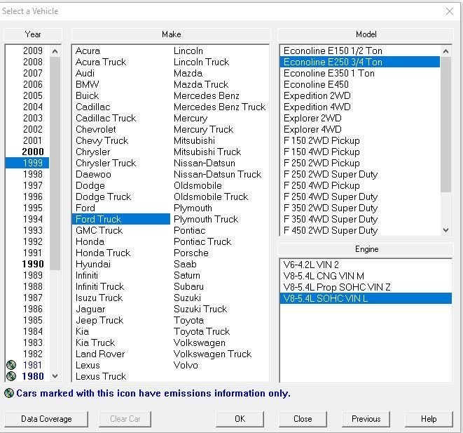

What is the 8th character of your VIN. L or M or Z?

The 8th letter is "L"

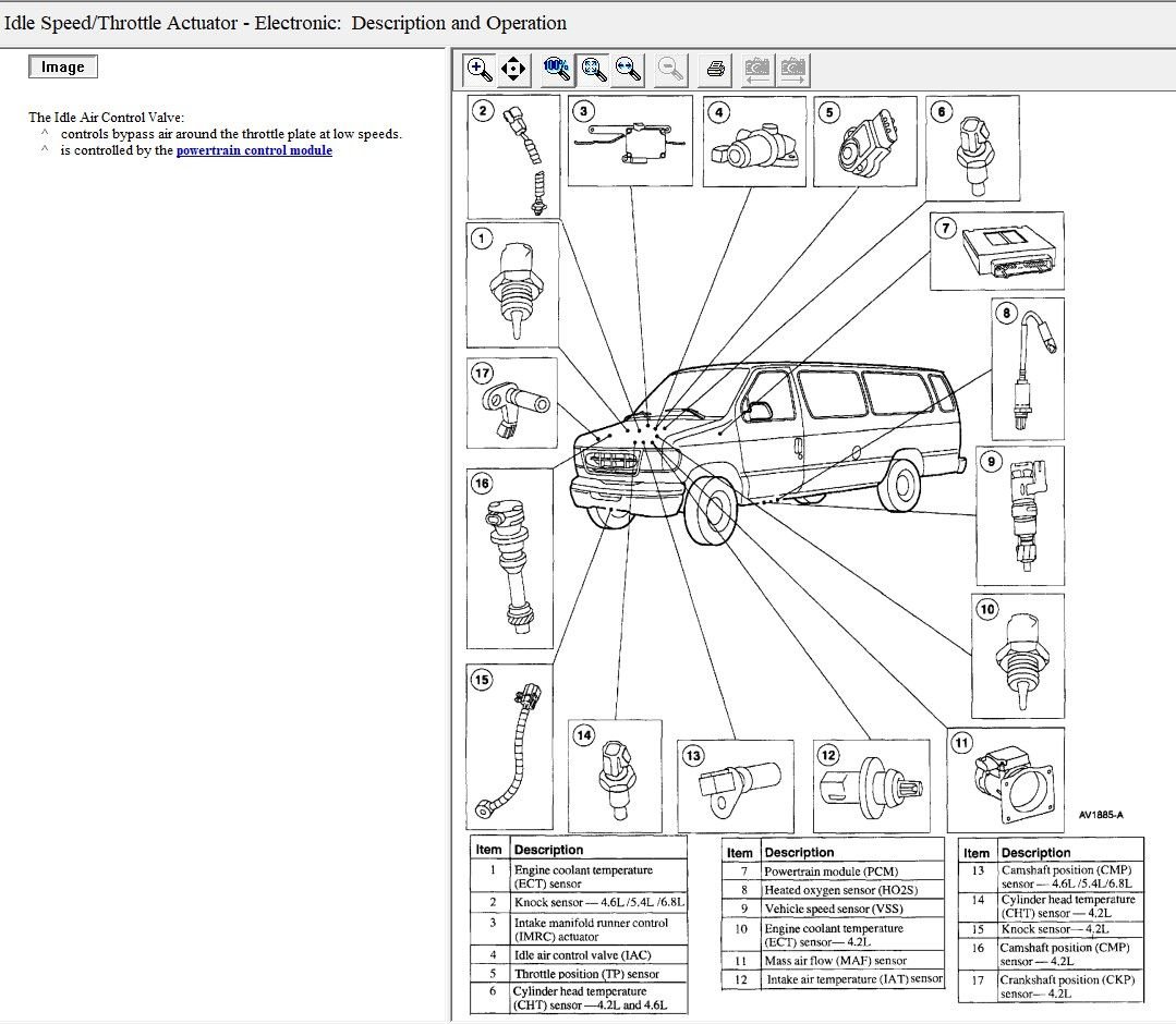

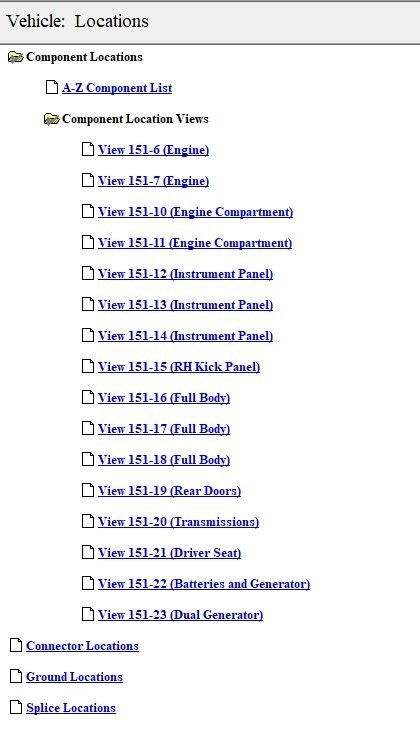

Below is the Locations index page of All-Locations.pdf

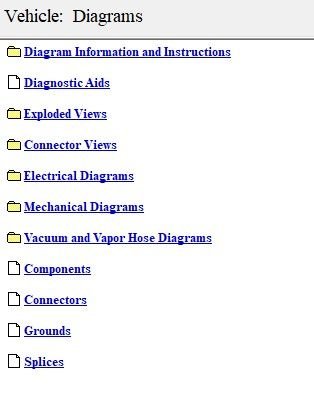

Below is the Diagrams index page of All-Diagrams.pdf
When you don't have the exact DTC without a CEL, it also indicates that the issue is not critical enough, so I can only try to cover as much relevant info as possible.

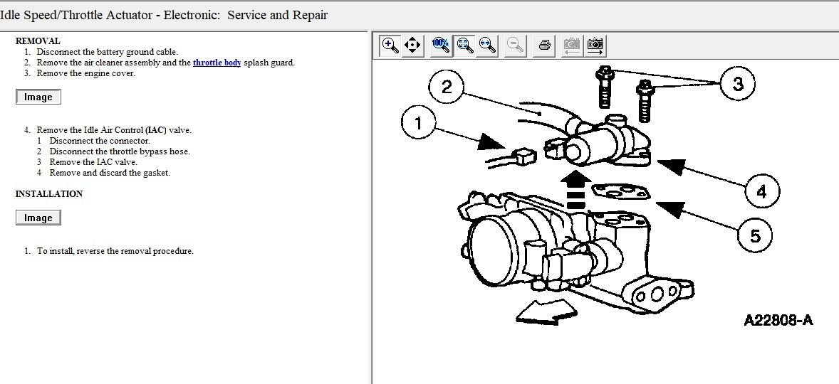

The All-xxx.pdf attached below, they are huge pdf and complete, I have created just the index page snapshots so you can navigate and follow easier. The All-Pinpoint_Test.pdf covers all the tests and I randomly picked out a few for you.
All I can suggest, before throwing parts at it, any sensor you remove, clean accordingly. Electrical connector, clean both ends using contact cleaner or 91% isopropyl alcohol.
