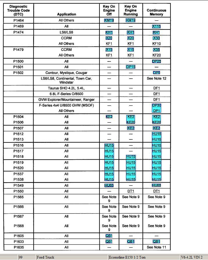

P1504
Old Mar 22, 2025 | 10:42 PM
  #17

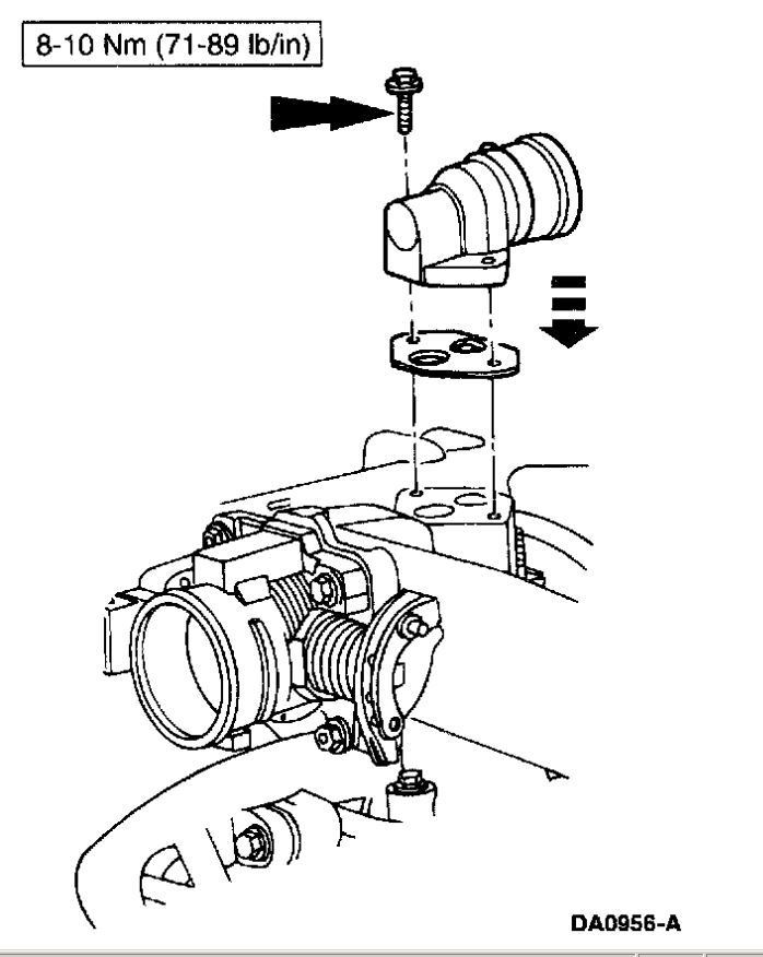

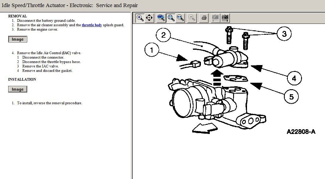

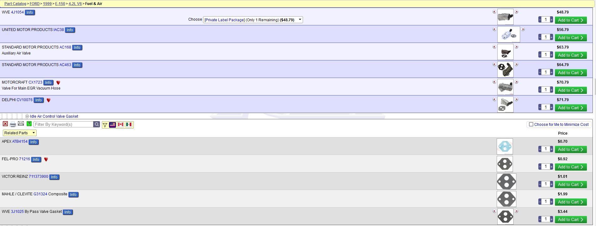

Follow KE2 and test first, then remove and clean if needed. If you need cleaning be sure to replace its gasket. Erase the code after cleaning, and run KE2 again if needed.
You can use throttle body cleaner for cleaning, don't need to buy new IAC, save your money for something else.
# 2 - IAC
# 3 - IAC gasket
Say you want FEL-PRO 71216 just search this at google and buy at autozone or amazon just because rockauto does not offer free shipping.

PikaDrew's Avatar
Joined: Feb 2025
Posts: 31
From: WI
GOOD NEWS! No more ticking oil was changed IAC was indeed bad even tho it was plugged in, replaced that, still have high idle on cold starts but it goes down after a few seconds.

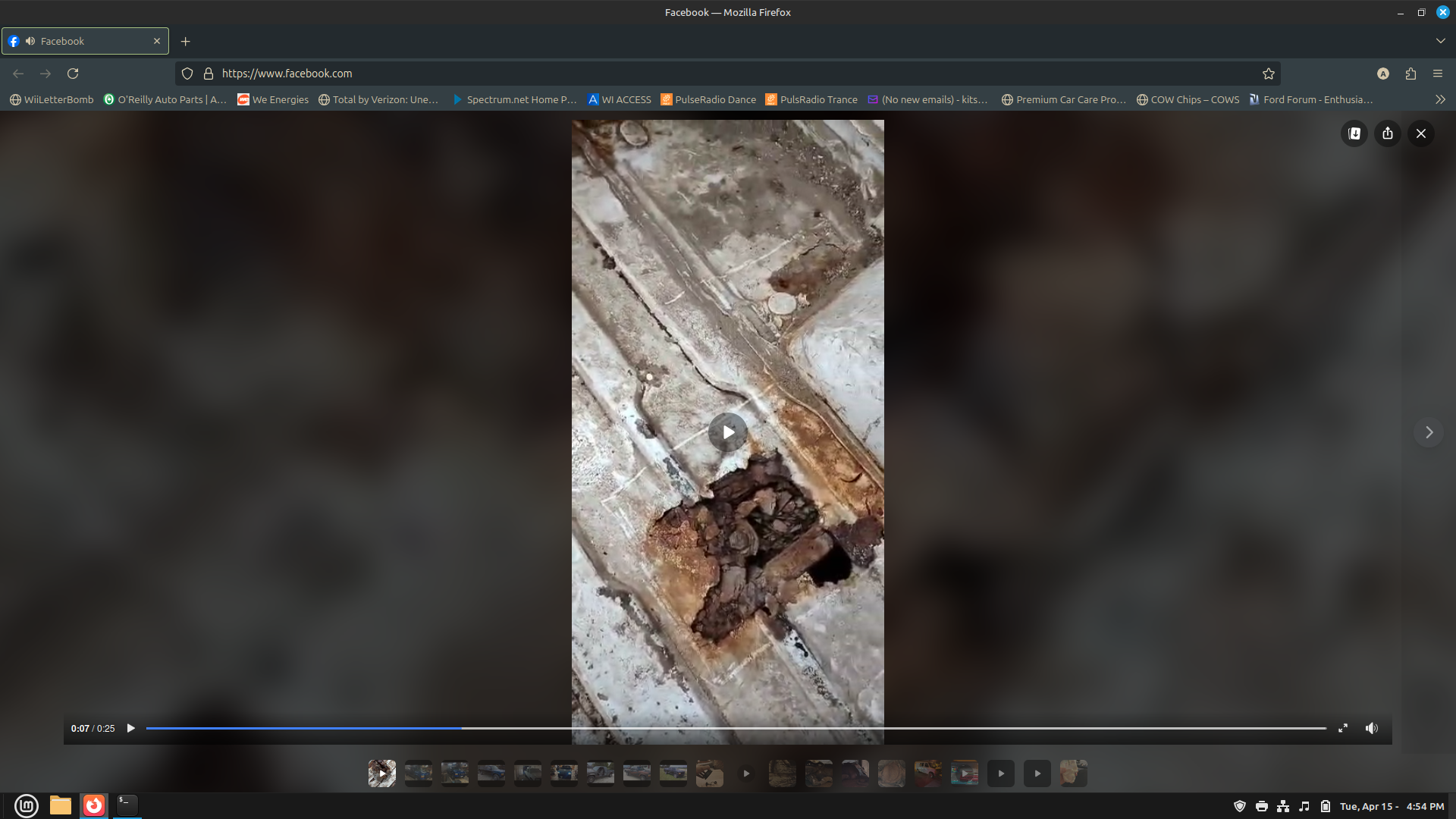

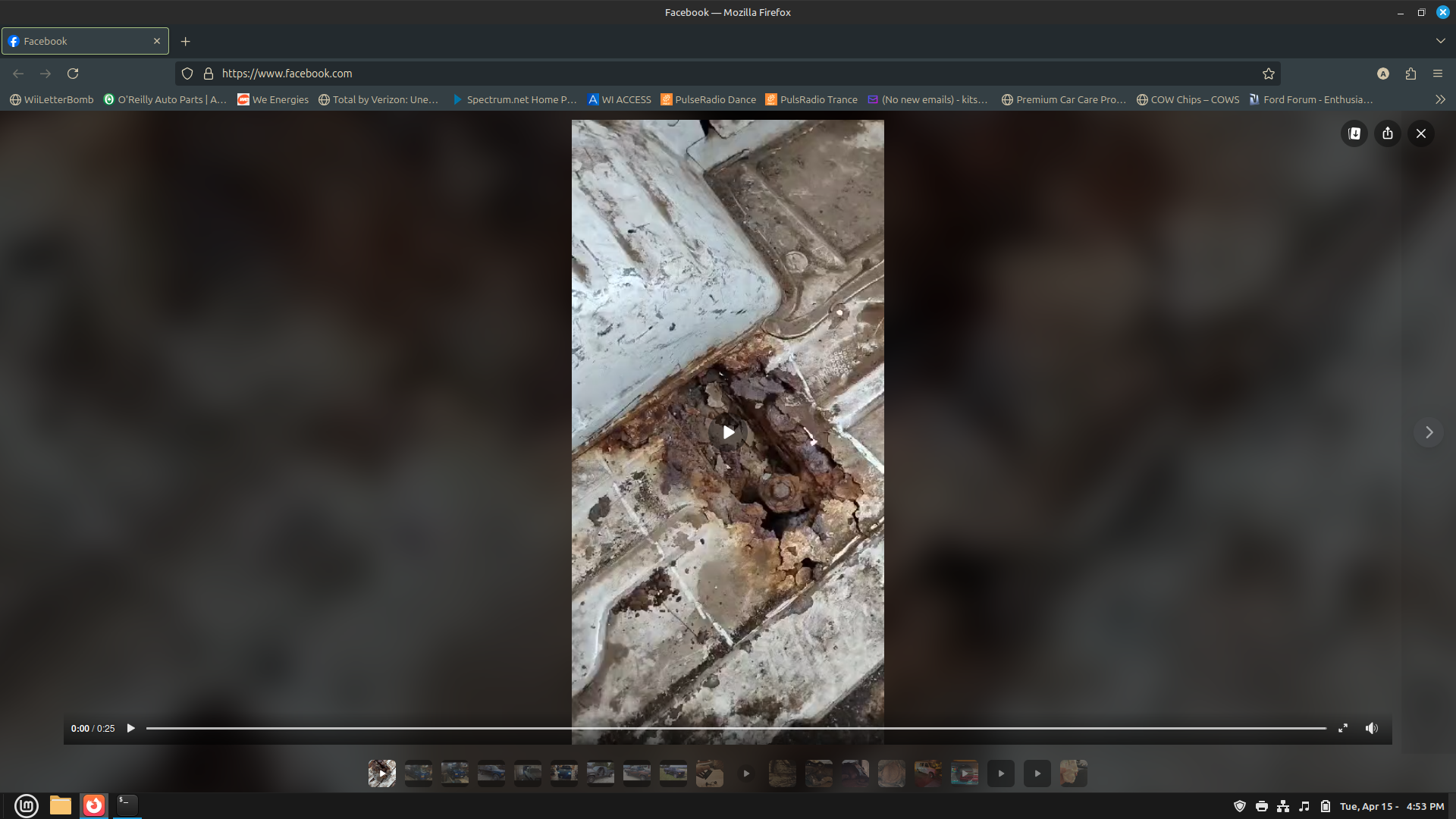

PikaDrew's Avatar
Joined: Feb 2025
Posts: 31
From: WI
The Really bad spots that my buddy up North is gonna help with. Nasty rust!
