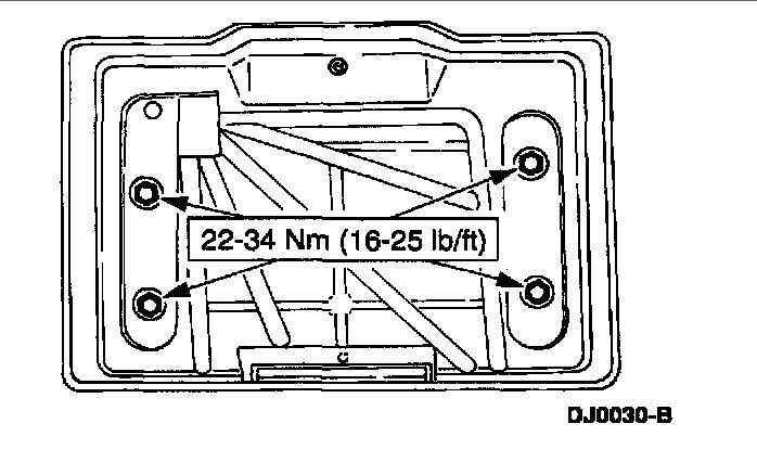

2) Remove the bolts then remove the battery tray as shown below

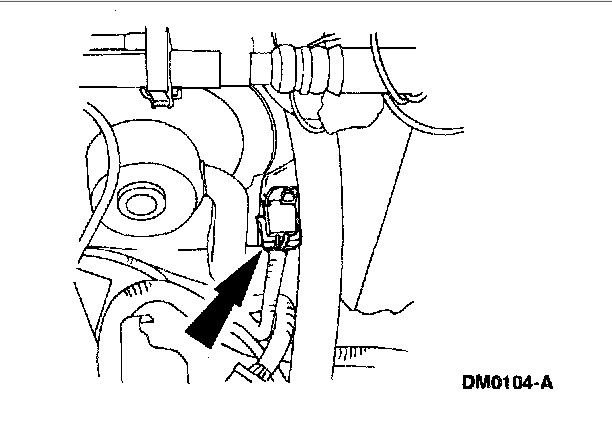

3) Disconnect the heater blower motor switch resistor connector as shown below

7) Reinstall and torque down the tray as shown below
