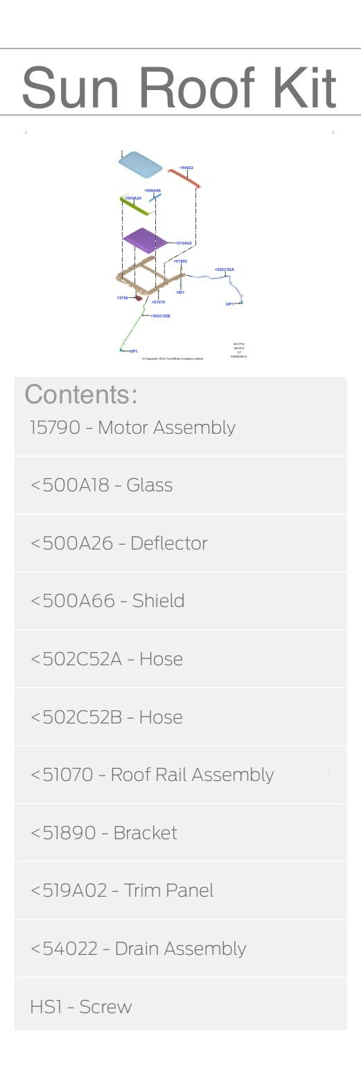

*I ran across this thread, while searching for shield installation how-to videos/instructions*
I am having issues w/my sunroof - I cannot even use it now, without it getting stuck! After a lot of uncomfortable and neck-breaking study of the actual mechanism - I believe my issue is the shields too!!
(My husband just used brute force several times, to ram it closed - and now it’s all effed up!! 🤬 Seriously works my nerves - because he’d NEVER do that type of thing to the Harley or Tundra…)
But I digress!!
Anyway, I was able to find the Shields for my 2019 FF Titanium Hybrid at around $22.But after reading through this thread today, I am worried I do not have the correct part, because why are mine only $21.50?!(Link above and pic attached)
I apologize in advance, for any ignorance I have showing.
I appreciate any feedback…
Thanks a Bunch Y’all 😉
