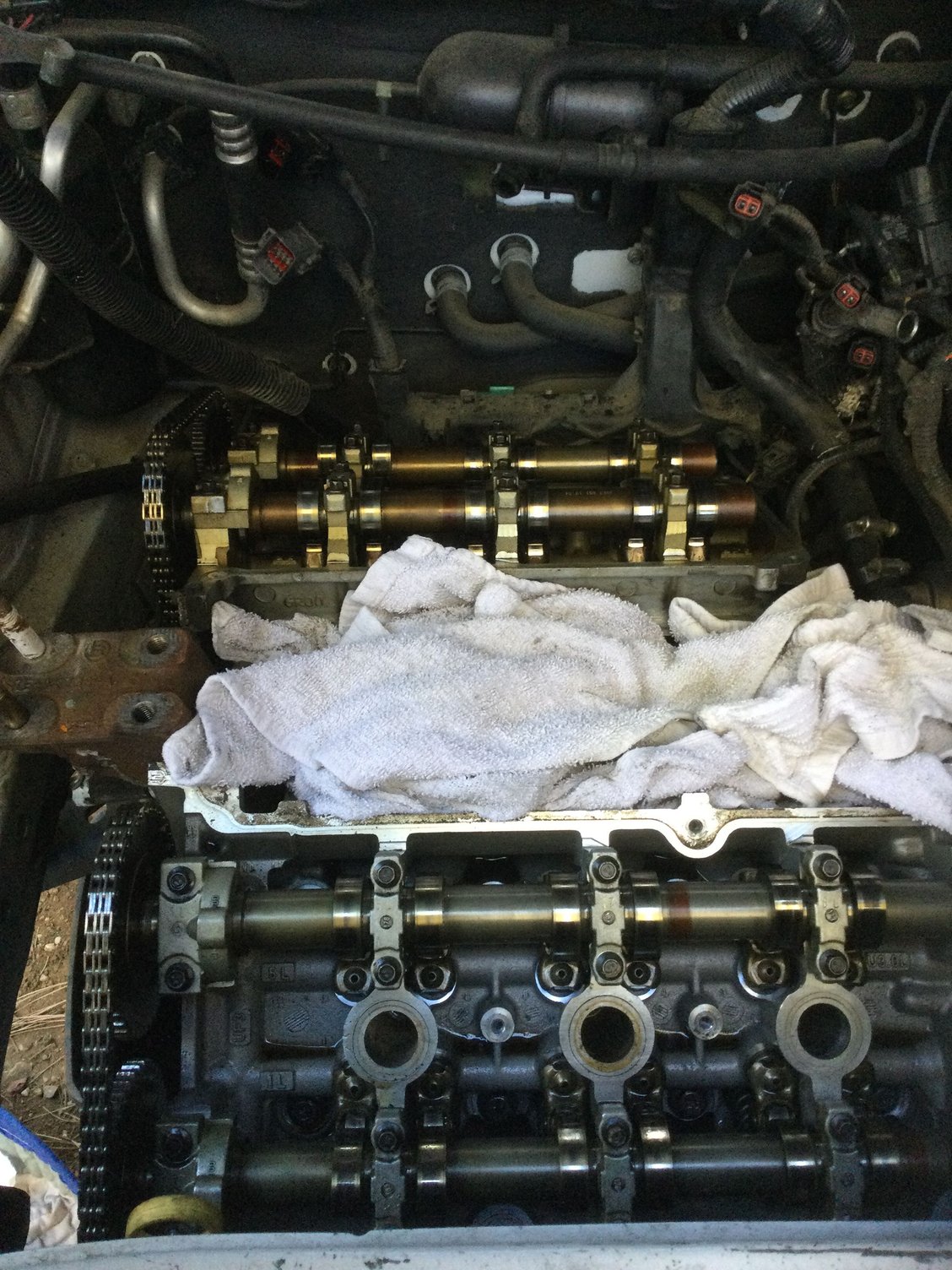

So I finally took it apart today. Was prepared to find timing off. But it wasn’t! I was so angry!😡. Checked it multiple times. Very frustrating. I was so sure that I bought all the stuff to replace the chains etc. at this post I don’t no what to do. I’m in it this far do I pull the head? I actually found out ford replaced this head in question under warranty. And I can tell by the oil stain of the components front bank is allot cleaner. Just don’t get what else would cause all 3 cylinders to have 60psi out of the blue?
