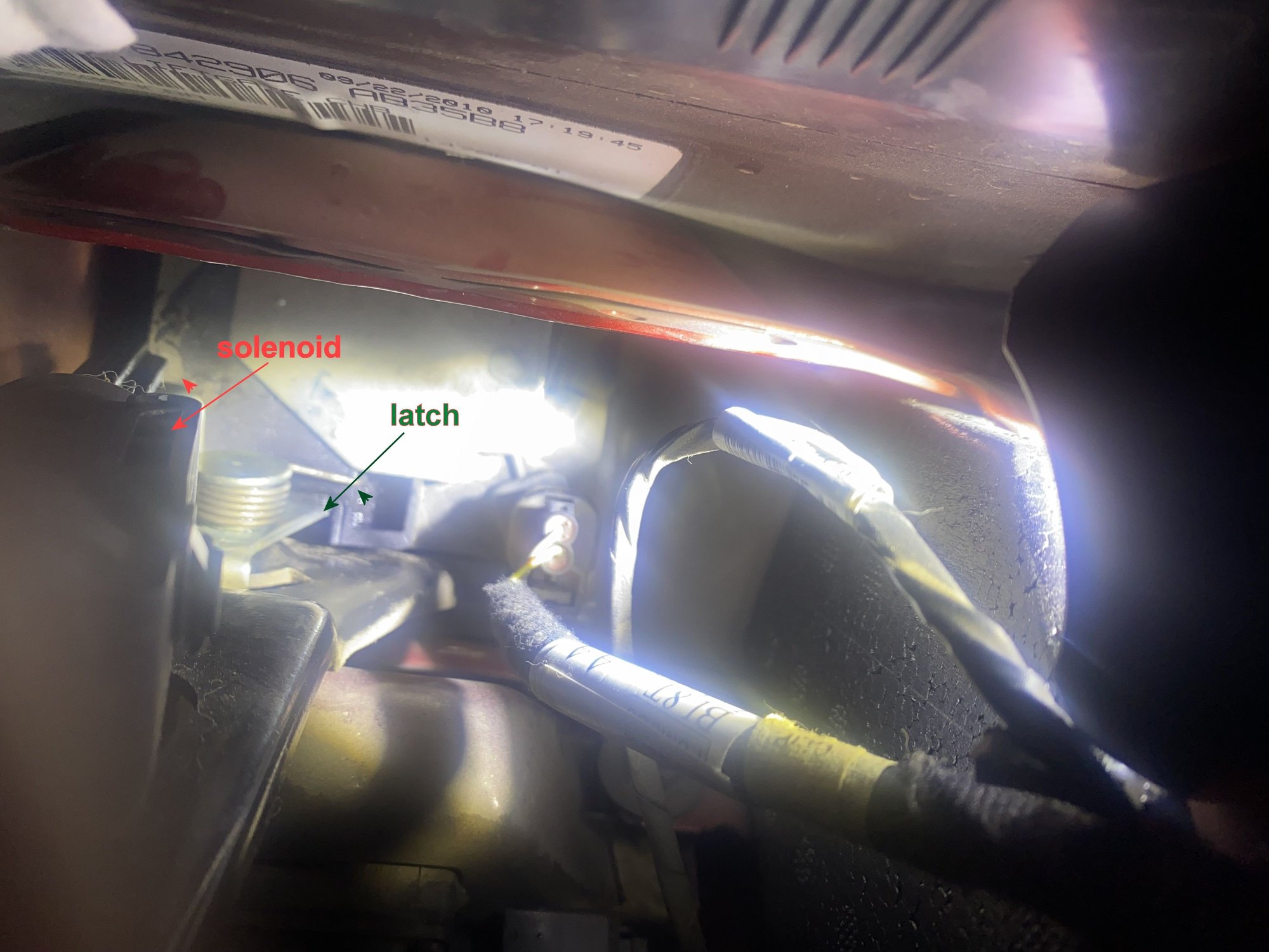

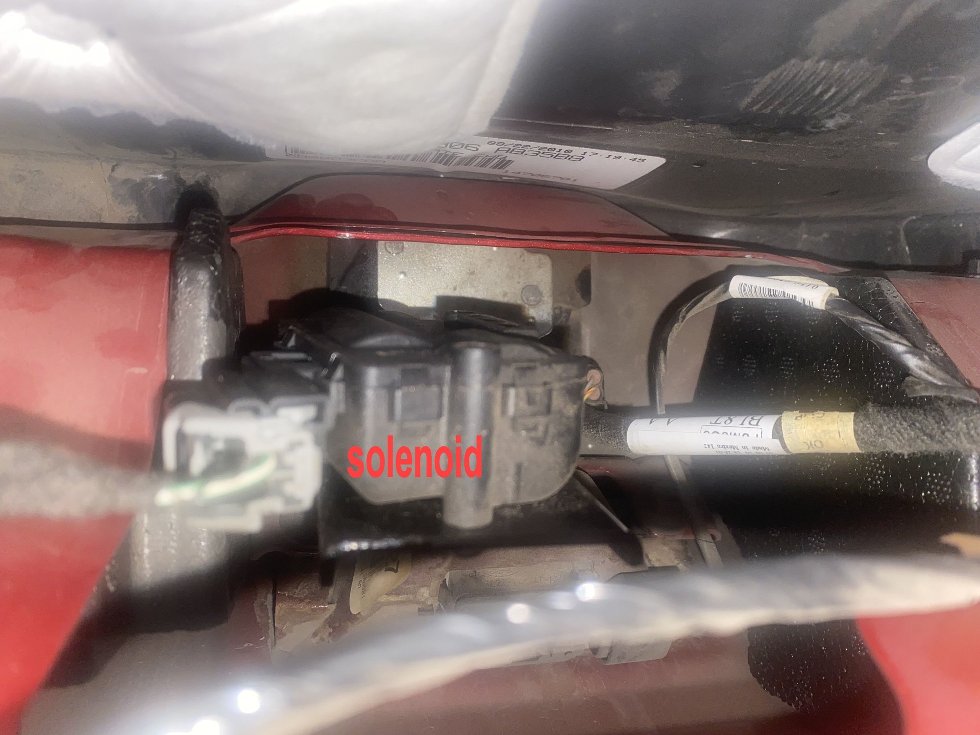

With window up and plastic cover pulled away I can access the mechanism. If I push in on the door slightly I am able to try opening it and hear a slight click and see a small movement of the solenoid and latch but won't open. I try to help the solenoid pull up on the latch but not enough movement or ???

Default Found repair video but now another problem
Video shows all I need to repair but..........
It was obviously replaced before and the 3 torx screw securing it were over tightened and won't budge. Torx bits slip and round out the slots. AARRRGGG!
