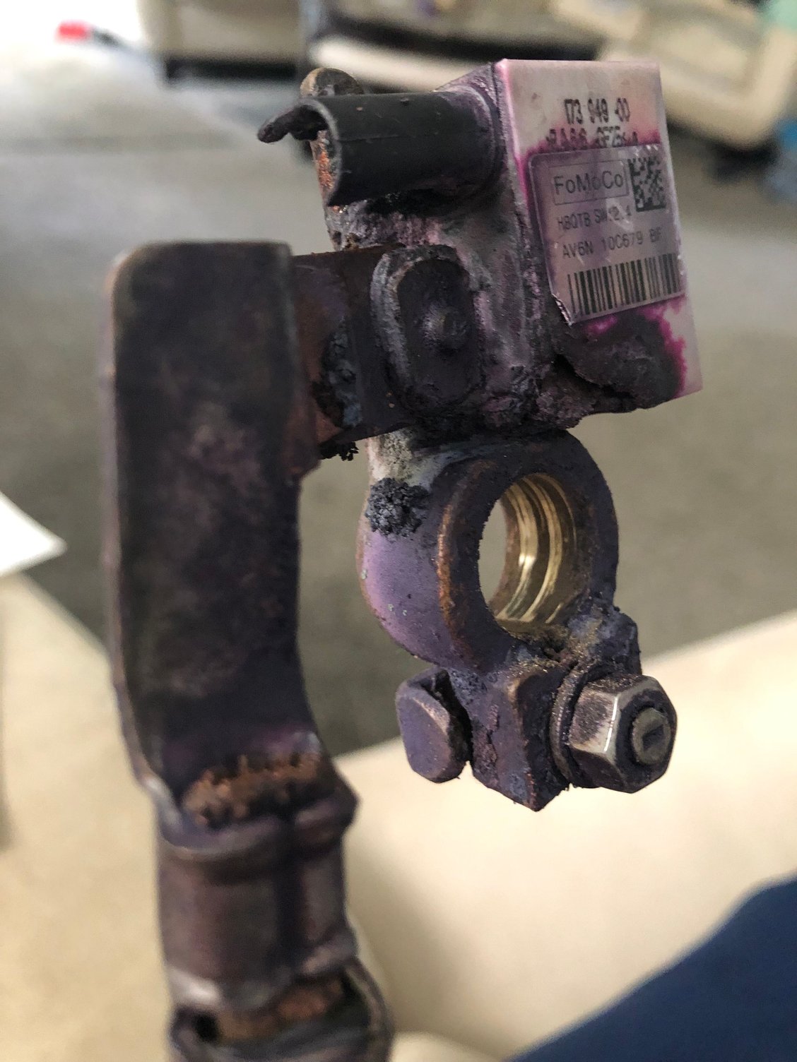

I pulled into a parking space and before I could get the car in park, it shut off. Thought it was a bad battery. Couldn't jump it, had to be towed. Got it started at home with a jump starter. Replaced the battery, ran fine for 2 weeks. Parked at a store, went to get back in it and it wouldn't start. Jumped it and could get it to started but ran rough (sounded choppy), and idled rough. Not drivable. had to be towed home. Couldn't be jumped. Started fine all next day. They determined the ground post may have been loose. When they wiggled it, the dash lights and interior lights would flash. Tightened it up. Test drove it. Drove fine. Let it run for 10 min. Turned it off. Went to leave, wouldn't start. The interior lights and dash lights and airbag lights and AC were flashing and wipers working. He was able to get it started by beating on the steering wheel. (He was trying to diagnose the problem). Turned on the headlight and car started extremely rough like before. As seen in video. Not drive able, every time I put my foot on the break and tried to put in reverse, it died (I wanted to put it in garage) The next morning the car started fine and acted normal, I was able to pull it in garage with no trouble. He did some research and felt like the ignition could be bad, so he replaced the ignition. Car worked fine. Took it on a 15 min test drive at all different speeds and brakes and it was fine. So he replaced the steering column cover. Wouldnt start. (He replaced it

Thanks for the answer, he will be over tomorrow and I’ll show him your reply. Today the car started just fine. He took off the negative battery cable, and it was seriously corroded. And the pigtail wires that connected to it were melted. So picked up both of those at a ford dealer and will see if that is the fix tomorrow. He’s currently trying to figure out how to reset the battery monitor.
