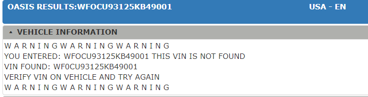

VIN is WFOCU93125KB49001

So I guess I dont have access to vehicles sold outside of north america.
Granted you ended up confusing me with what the issue is now.
