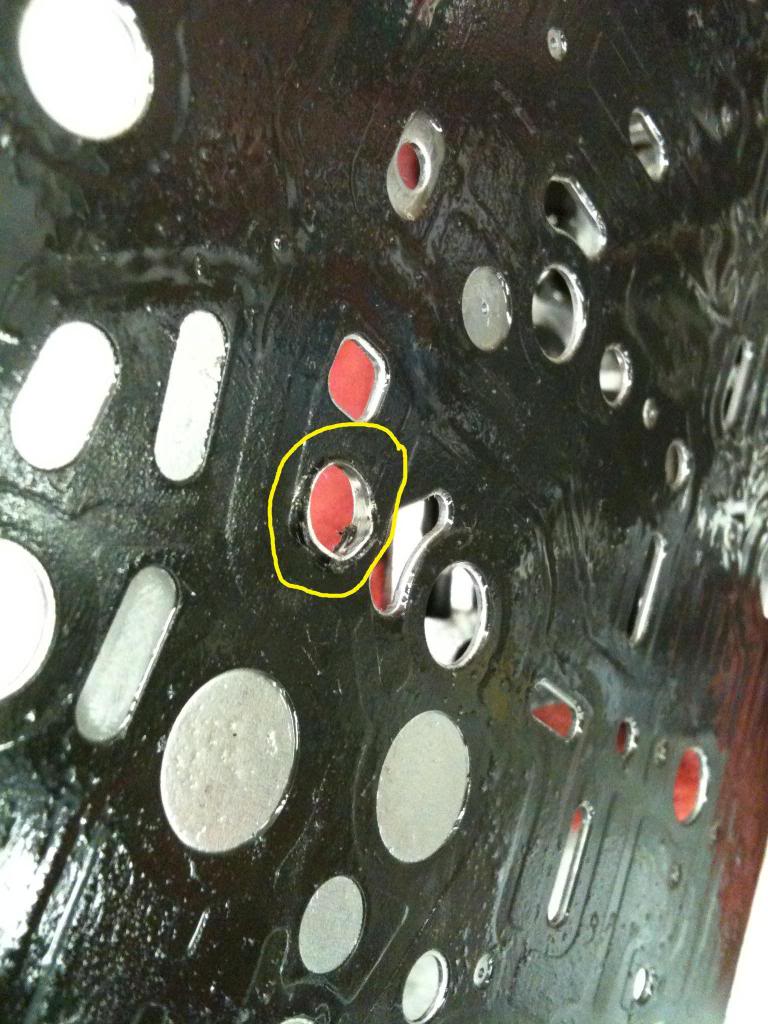

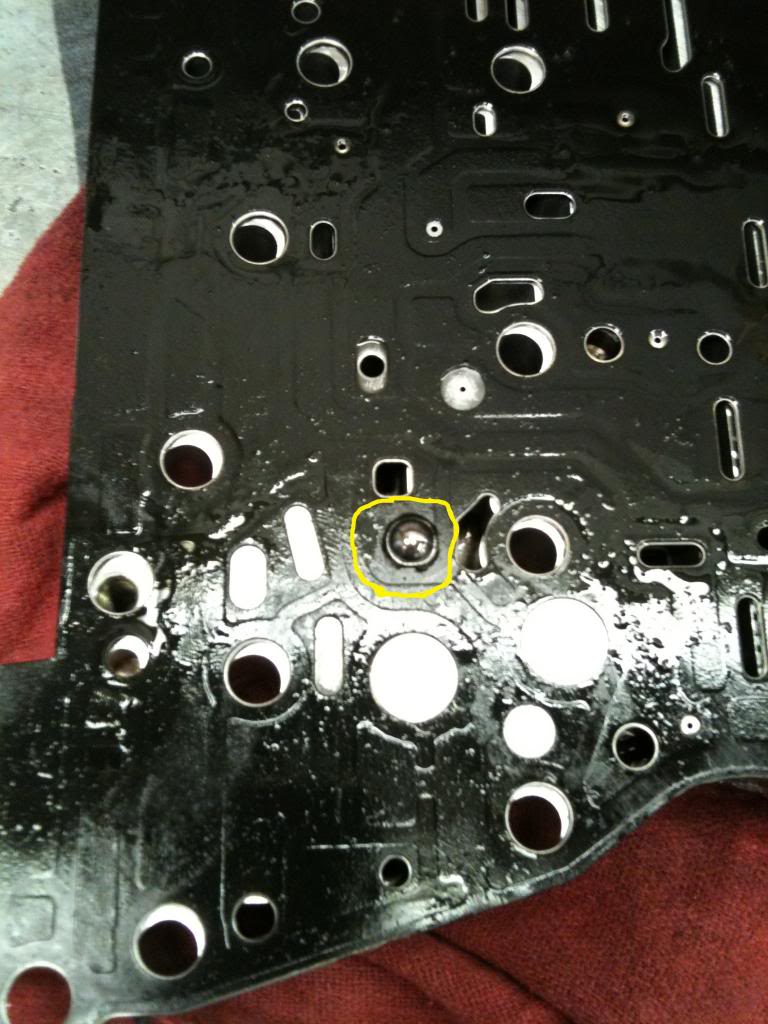

If it happens all the times then it's likely the 35R circuit check ball blowing through the plate. Eventually you will lose reverse or have partial reverse and possible missing 3rd and 5th gear if the check ball blows through the separator plate to the other side. I can post pics tonight if you are going to pull valvebody.

Old Dec 19, 2013 | 10:36 PM
makuloco2000's Avatar
Joined: Mar 2013
Posts: 325
Joined: Mar 2013
Posts: 325
