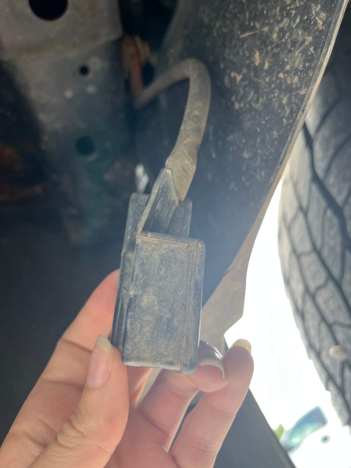

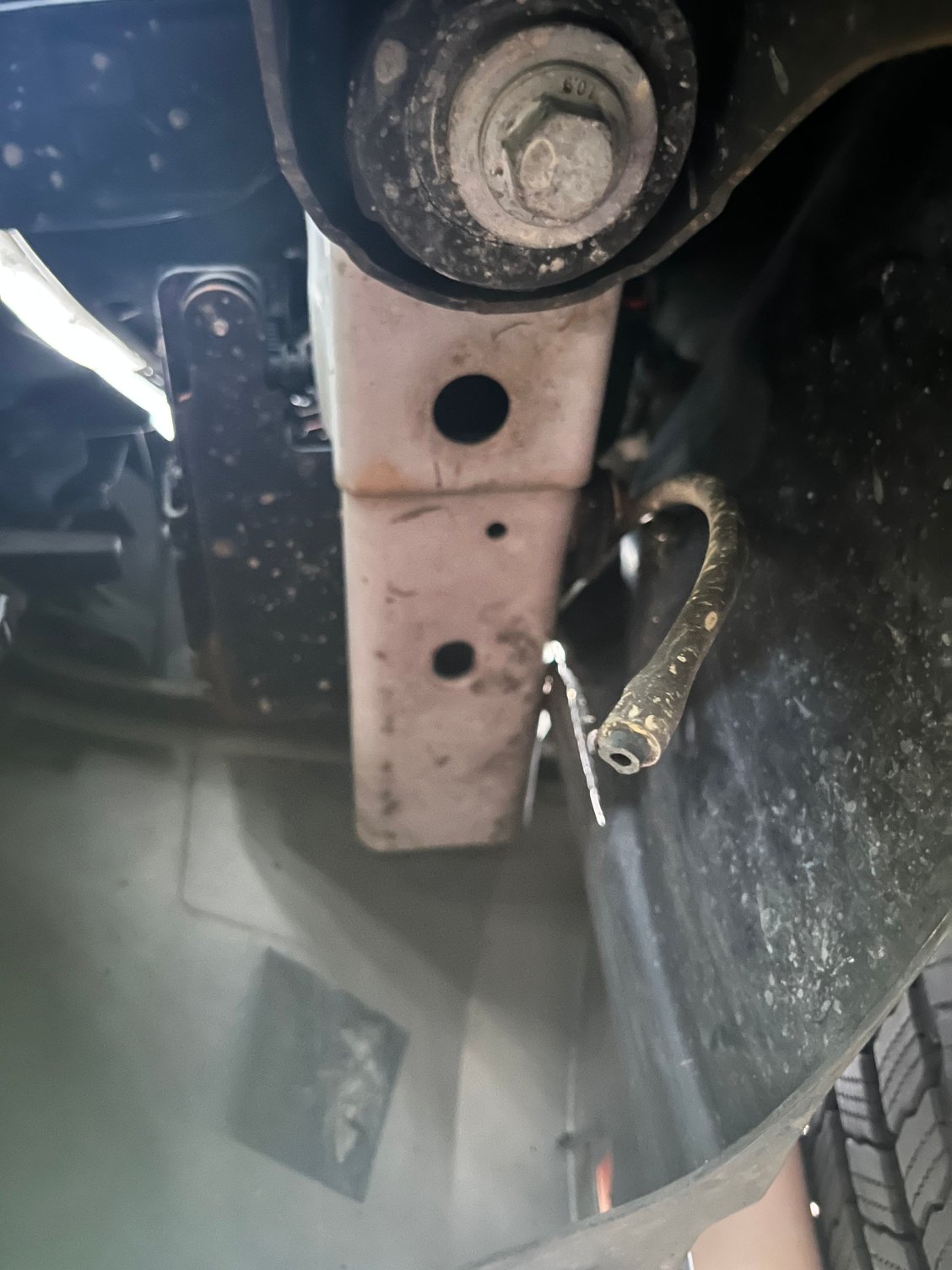

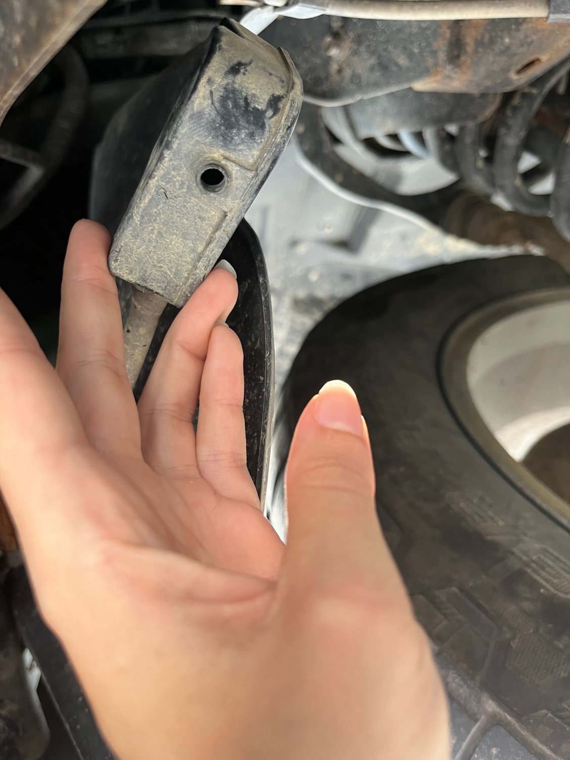

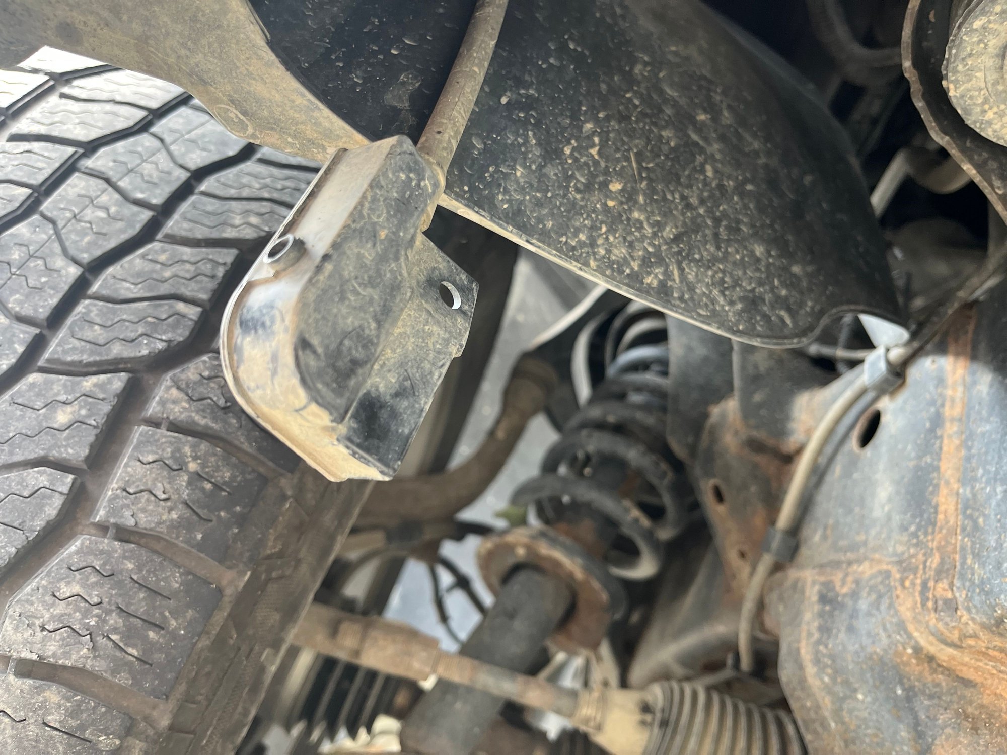

Hello! I recently bought a 2013 Ford Expedition EL King Ranch with 146,000+ miles. I love it but of course has been having a couple issues. After reading through a few threads and watching a few videos I believe I have an issue somewhere with my 4WD and possibly brakes. Whenever I get around 40mph or try to go uphill I get a noise, I do have a few videos. While looking for said problem I found a hole in my vacuum hose as well as some hose not connecting to anything. After comparing my vehicle to another 2013 expedition I found I am missing this little part that connects to a hose from a compressor right behind the passenger headlight. Not sure what this tiny part is or what it does and would appreciate any help! I did have new brakes and driver side caliper replaced.
This is my hose with the part missing.
Hose of other expedition with part attached.

It's a vacuum reservior. Is it hard to stop, like press the pedal down. You need vacuum so the brake booster can operate correctly. Also the 4WD is vacuum operated so your hubs will always be engaged. Your engine may also be running less efficient than it should. If you have the 3.5l turbocharged engine the wastegates are also vacuum operated.

Good to know, thank you! I’ve had my brakes, front left caliper and brake hose, a vacuum line fix, as well as solenoid replaced, and I just replaced the part I have pictured. I still have a rattle noise while going uphill while using cruise control but it’s not as often as before. My dad was a mechanic so it’s hard for me not to search for a fix to my problem.
