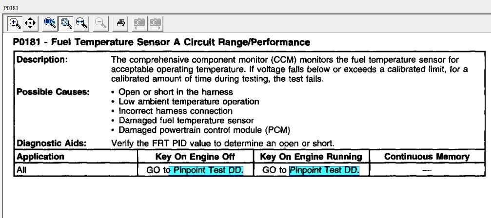

Old Nov 21, 2025 | 05:25 PM
Posts: 1,254
