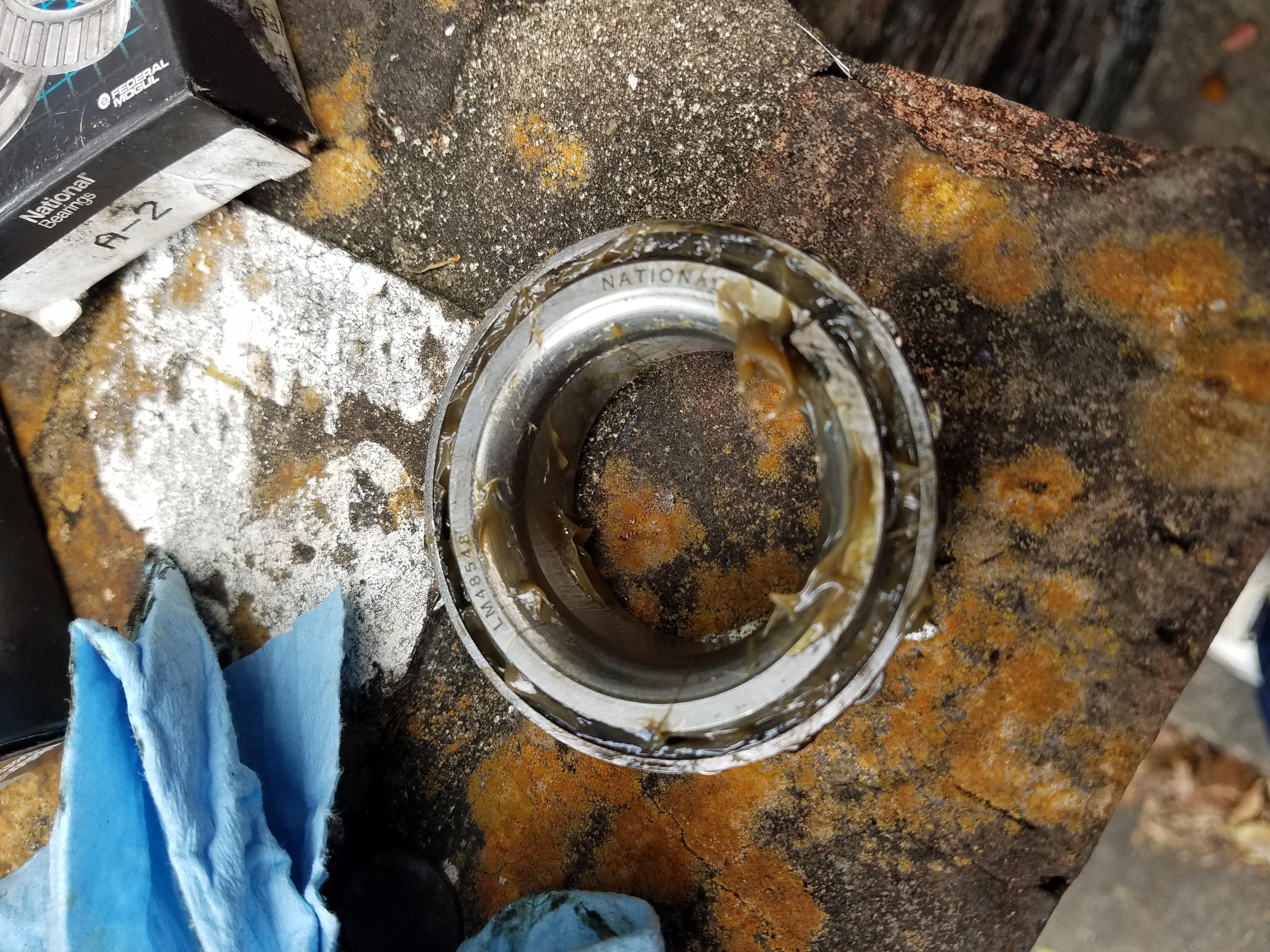

I replaced my front rotor and bearings. While test driving as i come to a complete stop i feel vibration on the brake pedal and a light grinding noise. When i pulled it back apart the shaft had a black ring around it as well as the bearing. Any ideas what is causing this? Thanks Joe

Its the inner bearing that is rubbing on the shaft. Both the bearing and the shaft have black rings. How do i upload pictures?

think i figured out how to upload photos
Attached Thumbnails 99 explorer bearing rubbing on shaft-20170401_132958.jpg   99 explorer bearing rubbing on shaft-20170401_133022.jpg

Thanks for the pix, maybe we can help.
That steel sealing ring on the spindle that the bearing goes against, and the seal rides on, may have an indexing pin under it . When you have the rotor removed that ring may have moved away from the final position. Take it off, if it comes loose and check for an indexing pin and hole in the back of the ring, then reinstall it making sure to have it fully seated against the spindle. If it was not positioned fully it could have kept the sensor from working correctly and dropping out electrically causing the ABS system to react as if the wheel was locking up due to the loss of the signal.
Let us know what you find, will check back later .

Well after getting the abs checked out all sensors are working properly. Ended up unplugging it for now. Any ideas?
